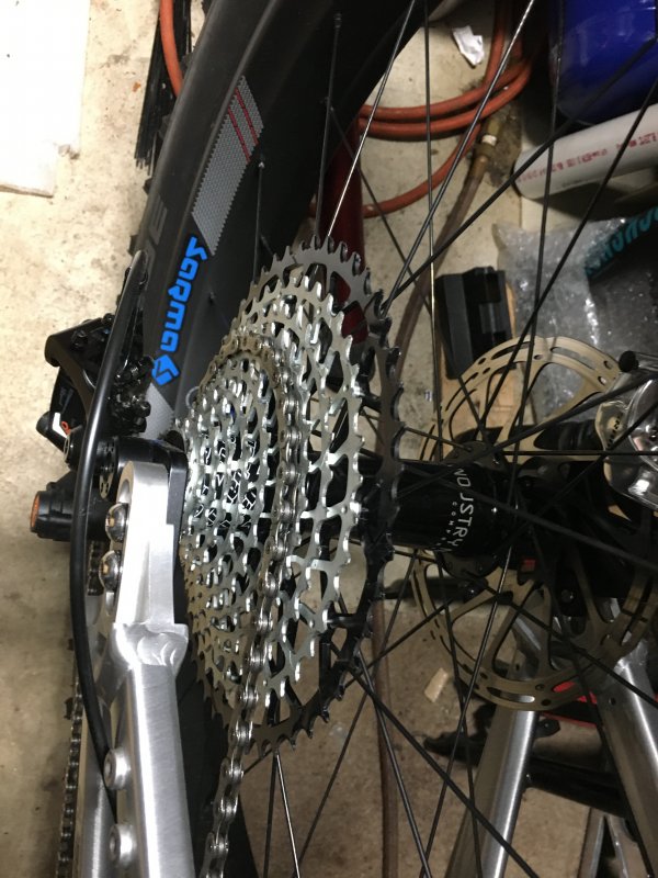

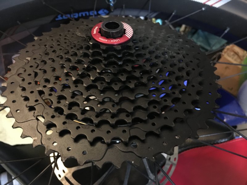

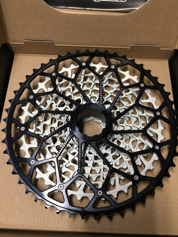

Rainy weekend so had time to do a number of projects. First up was a nugget shipped from Poland.
Replaced this hunk of metal...

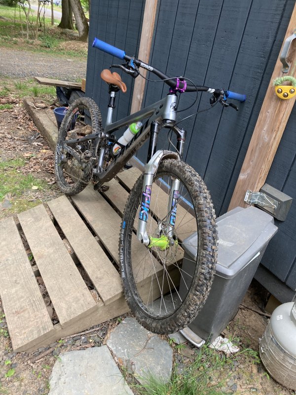

After a bunch of tinkering, I now have this bike right where I want it.
I go back and fourth on the rear tire width 2.8 / 2.6”, but I’m sold on the mixed wheel size.
look for a new bike coming to market in June that (IMO) will kickstart the mixed wheel size trend. Others bikes for 2021 and 2022 are shortly following suit. I’m certain that this will be as big a trend as 29er was a decade ago.

serviceguy
look for a new bike coming to market in June that (IMO) will kickstart the mixed wheel size trend. Others bikes for 2021 and 20222 are shortly following suit. I’m certain that this will be as big a trend as 29er was a decade ago.
Sadly, the biggest obstacle for me would be to find a rim that I like that comes in both 27.5 and 29 size and 28H...OCD is no joke! I’m thinking 27.5+ in the rear (2.8, 3.0) and 2.6 in the front...dirt bike styke! Can be anything, not that I’m going to ride it anytime soon anyway!

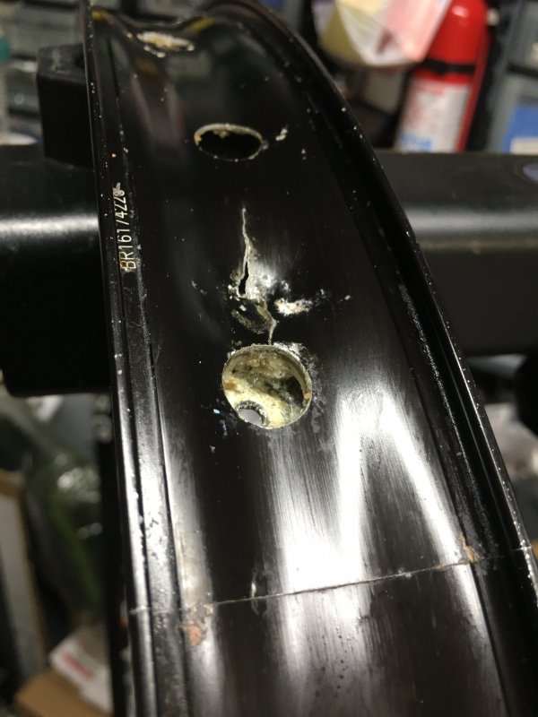

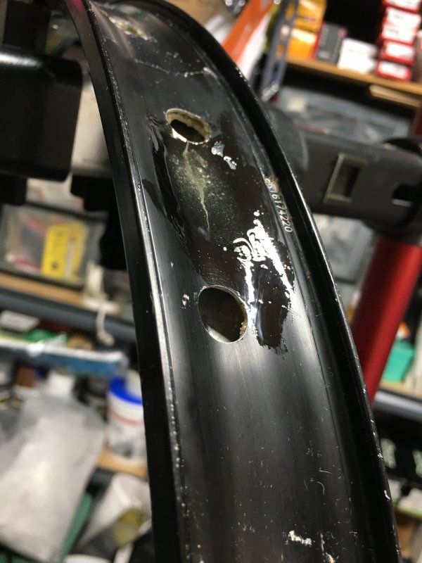

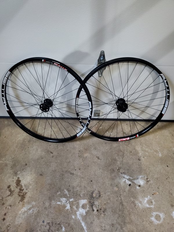

Tore down a used rear wheel for a riding buddy to re-lace the rim to a 177 hub for his Mutz. Found this nastiness inside.
He still wants to give it a go so out comes the epoxy.
Not too late, drill a stop hole at the end of that crack. Epoxy by itself won't do shit to stop it.
Looks like a classic "ran over a giant nail/screw" damage. I've had/seen several rims that have that damage, and they lasted for years. Admittedly, on road bikes, but it shouldn't explode, anyway.
