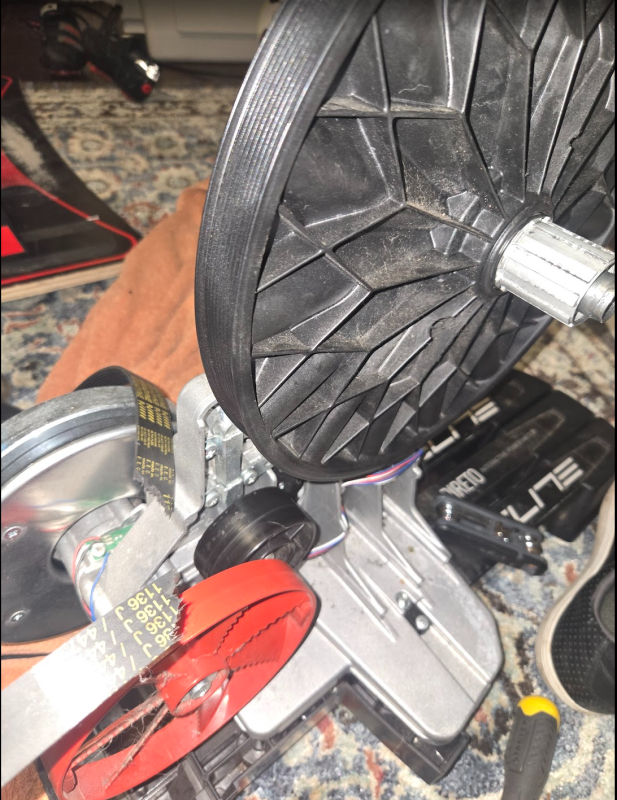

Looks pretty similar to an automotive serpentine belt, probably a little thinner though.after many many years with this Directo trainer....the belt finally snapped the other night...I didnt know what happened other than, it stopped working...so I took it apart and found this
Looked up that belt and of course, can't get it here.....trainer is made in Italy

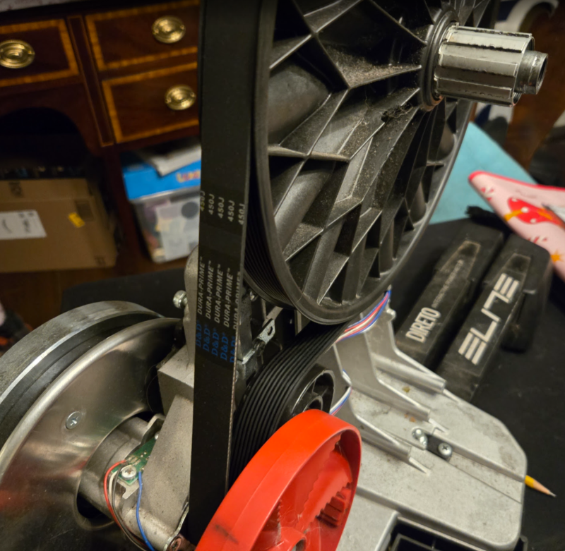

Thankfully after some interneting I found another belt from a table saw that would work
Back in action...I suppose I should recalibrate it, but not sure why I care
