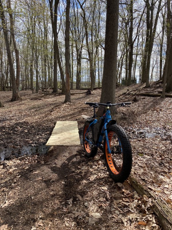

What I don't understand about the second picture is "Why?" The log has been cut for the "B Line". So why does the log have anything in front of/after it? I'd remove all of that and make the log an actual challenge for practicing good log-over techniques.
Why? For variety. For fun. What you can't see in the picture is the punchy little climb leading up to it to the left. It is actually pretty challenging to clean the obstacle going up. Is the log ramp needed when going down? No, but it's pretty f'n fun, especially at speed. That trail has a couple other logs of similar size that are exactly as you describe. The trail is clear yet the log remains as a B line.

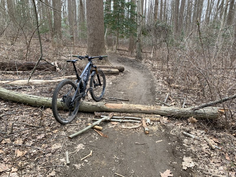

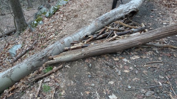

What do you think about this, OK, or not?
Looks fine to me. take the log if you want to, or go around if not.
I don't understand the other "feature" in your other pic. Is there a purpose to all those sticks, other than to lodge in your spokes or cause other mischief? The tree looks small enough to go over, but not sure of relationship to the other substantive log on the other side.
I didn't understand the "feature" either, someone must have thought it was a good idea, I just am reporting what I saw,
Yeah... that is the type of log I'd probably jump over if given the choice. Oddly enough, I am more inclined to ride over a log that doesn't have ramps built up than one that does. It does depend on the log and the trail, tho... if the approach and landing are good, I'll jump over the log without using the ramps. Depending on how I feel, I can usually get over a log around 2' diameter.
Here are my personal thoughts, which could be incorrect as far as trail building doctrine are concerned.
I don't see a problem with stacking a few decent sized logs in front of a big logover. By big I mean like 12 inches or more but probably more like 18". For the smaller logovers the stacked logs are in no way needed. You can pretty much just roll the log with minimal skill. The small size diameter branches needed to stack in front of smaller logs are fragile and don't hold up for very long. They don't stay put and become a liability in short order.
As someone who has a pretty practical bunny hop in my bag of tricks I can say one of my biggest pet peeves is coming to a small logover and having to deal with a bunch of small broken sticks laying all over the trail on both sides of the log at a time when I would really want clean trail on both sides. This is a prime example of totally unnecessary and, in my opinion, detrimental stick piling as this log can pretty much be rolled with minimal skill.
Now here is an example of a sturdy logover that does warrant the stacking of a few smaller logs on each side. This log could only be hopped by exceptionally skilled riders so the logs are a help. The logs used are also of a sufficient size and weight as to not move when the obstacle is ridden.
Again, just my $.02 and not based on any actual trail building doctrine.

first, FWIW, the picture #2 "feature" is definitely one of my favorite parts of Edith Stevens/Tingley Woods...as @Tim noted, going up requires a hard "punch" to clear it, coming down over the ramp is just fun...you get your cake and eat it too. also, tim failed to mention that feature was his handiwork! again, it's super-awesome!

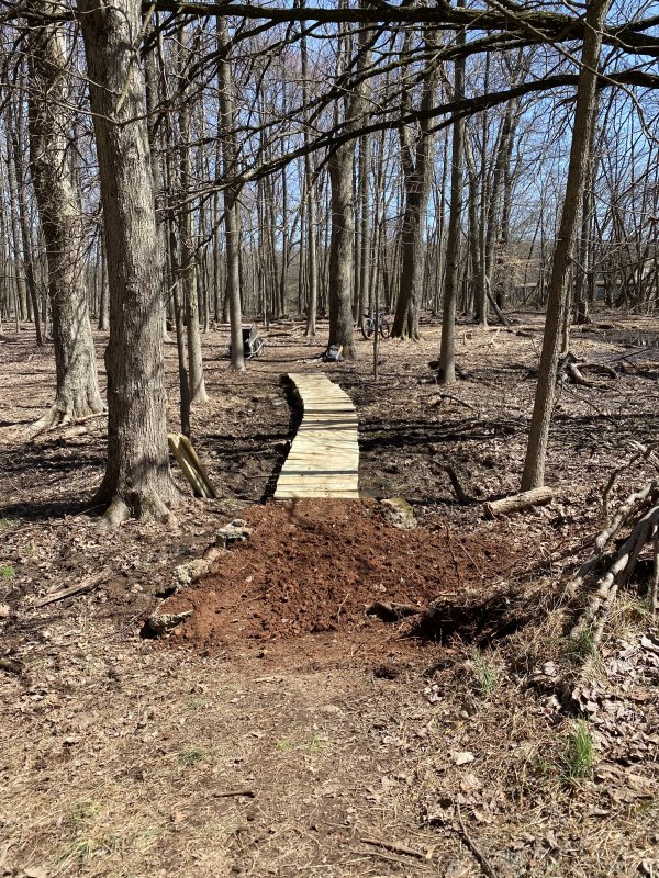

as for the rest of this thread, i've been amateur trail building here in Edison for about 3 years now. i've learned a lot by observing what works/doesn't work at other trail systems, hand on trial and error, googling/youtubing, and some actual reputable reading material (see below)! water/drainage management has been my primary focus as we are literally in the middle of the swamp. and i agree with @Patrick, sticks just don't work (they simply don't last, and can exacerbate the issue), rock armor works well, when done right (i have not come close to perfecting that, and getting 'material' is a challenge...but my skills are improving)...reroutes can be deceiving, as sometimes that line that looks drier, is only drier because it hasn't been rutted up yet! i've recently been "dabbling" in boardwalks, with some pretty good luck so far!

here's my first two boardwalks (well, one is sort of a bridge i guess)...both built with locally sourced, downed trees for the supports...
that looks great. next time add an incline to make people earn it.
Make people earn getting up onto a bridge?

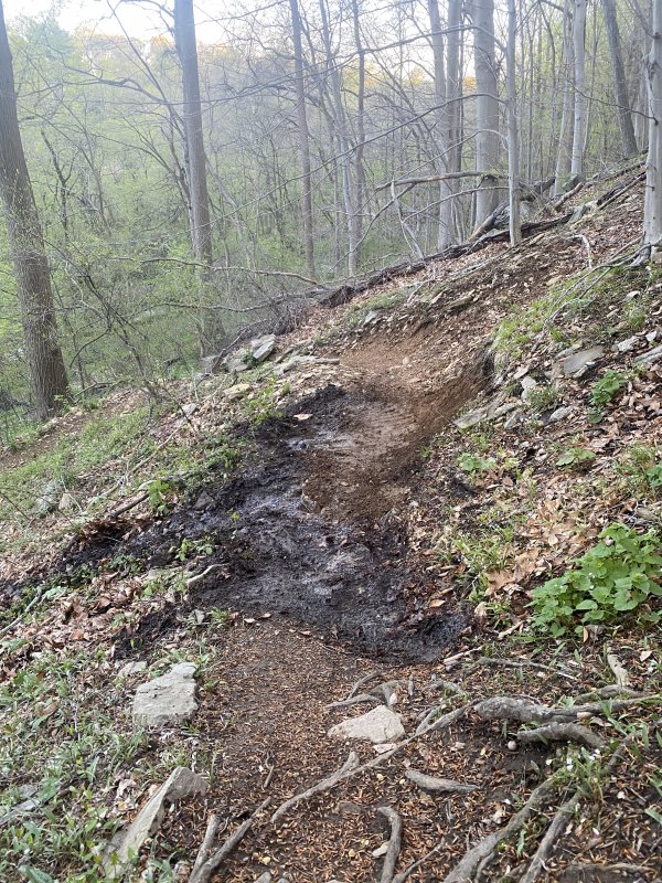

In other news, this area is in a bench cut area of Neshaminy (on the Mexican bow tie) and there is a rock on the uphill side that just leaks water. The water was pooling so I opened up the downhill side and did some armoring and bench improvements to get through the wet season and let it dry out. Unfortunately on Sunday, a moto made a rut right though the middle and around the corner and the water followed. Fart noise. In any case, will re-armor the drain once it dries out a bit.
