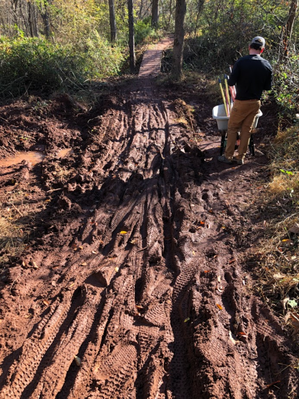

Now what type of work has J been doing at 6MR to remediate the perpetually wet areas? Rather than the water going where it wants,
he has been creating channels, and grade reversals to move water away from the trails. Creating low spots for water to collect and
drain away - We could use a few channels above the trails at the Sourlands,
to get the water to our armored crossings, or small bridges.
it looked bad when we did it - but dried quickly. Haven't been there this year. How's it doing?

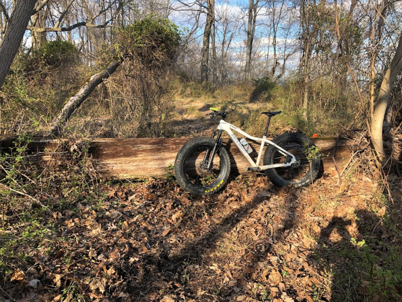

What's wrong with stacking branches in front of a log over (asking for a friend) ?
Here are my personal thoughts, which could be incorrect as far as trail building doctrine are concerned.

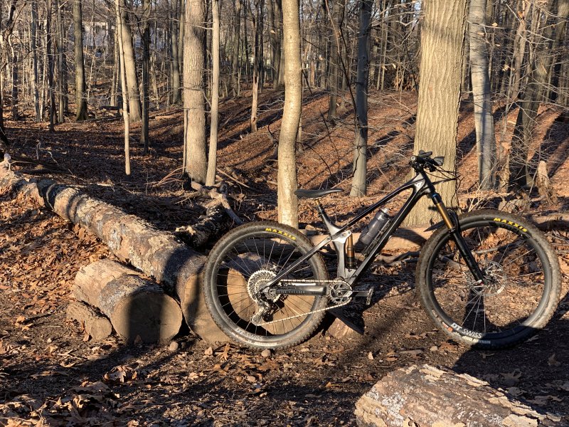

I don't see a problem with stacking a few decent sized logs in front of a big logover. By big I mean like 12 inches or more but probably more like 18". For the smaller logovers the stacked logs are in no way needed. You can pretty much just roll the log with minimal skill. The small size diameter branches needed to stack in front of smaller logs are fragile and don't hold up for very long. They don't stay put and become a liability in short order.
As someone who has a pretty practical bunny hop in my bag of tricks I can say one of my biggest pet peeves is coming to a small logover and having to deal with a bunch of small broken sticks laying all over the trail on both sides of the log at a time when I would really want clean trail on both sides. This is a prime example of totally unnecessary and, in my opinion, detrimental stick piling as this log can pretty much be rolled with minimal skill.
Now here is an example of a sturdy logover that does warrant the stacking of a few smaller logs on each side. This log could only be hopped by exceptionally skilled riders so the logs are a help. The logs used are also of a sufficient size and weight as to not move when the obstacle is ridden.
Again, just my $.02 and not based on any actual trail building doctrine.

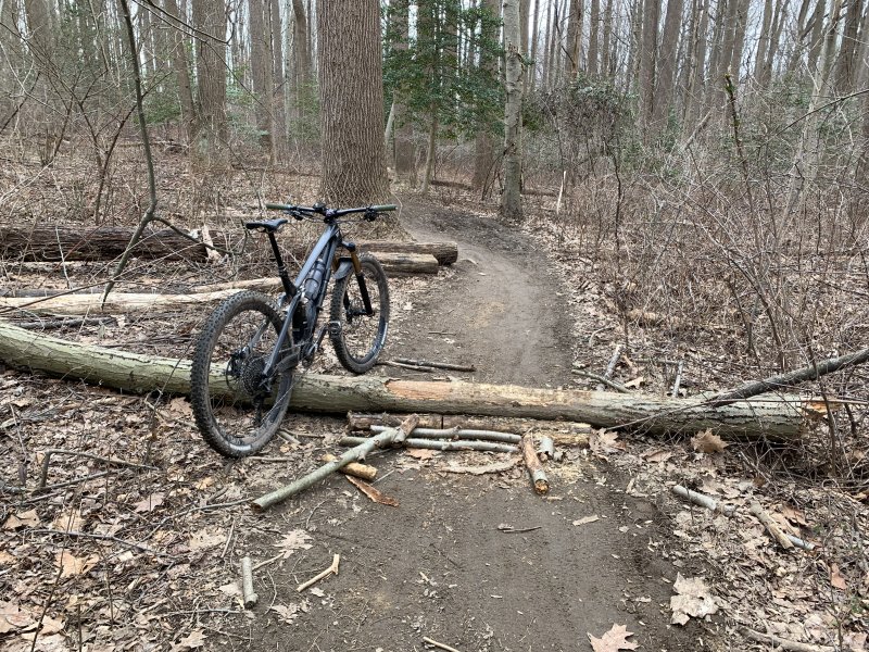

looking at your second pic - we did something like that at CR. cut out the trail,
ramped log on one side of the trail, and left the other. Options!
(at least i think we did it on purpose - it might have just turned out that way)
is it a true logover if it has a ramp?
Let's build a progressive log over and drop area!
Everyone thinks that smaller logs are useful when the main log is above X inches, where X is totally subjective.
Very true. My own opinion on this has certainly changed over the years. For me the issue is when the sticks/branches piled on the sides are so small that they break and/or end up at odd angles all over the place. At that point I think they hurt more than they help.
So in my second pic that is definitely more of a feature than a logover, I guess. The log was cut to clear the trail and the pieces were used to make a fun line to the side.
I think it would be awesome if we could get the green light to build some sort of skills park or even just a few progressive features. It would be a really fun way to hone some skills.
What I don't understand about the second picture is "Why?" The log has been cut for the "B Line". So why does the log have anything in front of/after it? I'd remove all of that and make the log an actual challenge for practicing good log-over techniques.
