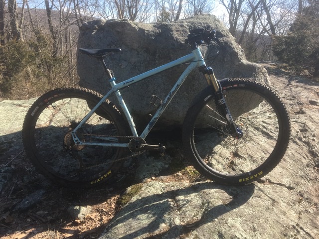

So today was able to ride the new to me light el mariachi on something else than fire roads. Tried and session a few features in Ringwood-Ramapo and Warm Puppy (thankfully nobody took pictures or filmed me, I felt rather precarious while doing it) but the old lady seems to handle everything I threw at it ( granted it’s not much). Loving the 2.6” Rekons
So today was able to ride the new to me light el mariachi on something else than fire roads. Tried and session a few features in Ringwood-Ramapo and Warm Puppy (thankfully nobody took pictures or filmed me, I felt rather precarious while doing it) but the old lady seems to handle everything I threw at it ( granted it’s not much). Loving the 2.6” RekonsView attachment 153787
Sweet ride!!! you need to bring that down south for part 2 of our ride.

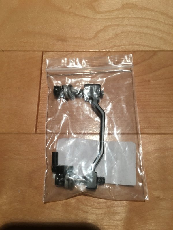

Post to post front 180 caliper adapter. The rest is in the mail (derailleur, chain) or I already have it.
By 2 you mean cm, inch of sizes? I need install the cranks and see how it feels. Maybe I should install the stem backward? I could not find anything shorter than 70mm.

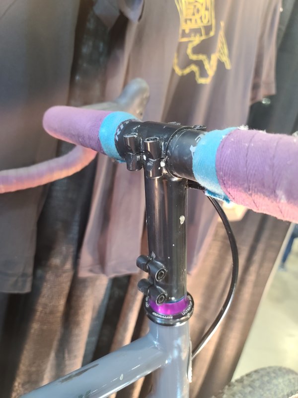

Was gonna post the Tanglewood Stem, but Soundz beat me to it...
I have a 35mm stem to use but I think I’ll stick with the 70mm instead, it feels right when seating on the bike. Off course it may change after riding it for an extended period of time (relatively speaking that is). Those contraptions look like they belong on a clown bicycle (and I am not the highest fan of clowns).
