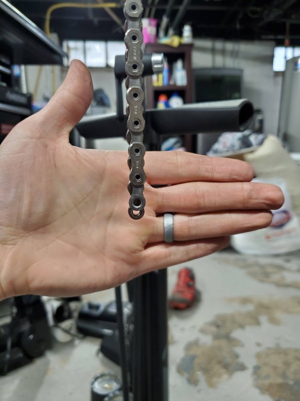

and this right here is what you are trying to postpone as long as possible by lubing your chain, front chain is a brand new sram x01 eagle (12 speed), back is a used (~1350 miles) x01 eagle chain (like for like) just to demonstrate how this goes.
FTR both are hanging off a finish nail in the ceiling joists of my basement, the dead chain measured .05 on my parktool wear gauge (both the go/no-go style and the one that actually measures)
