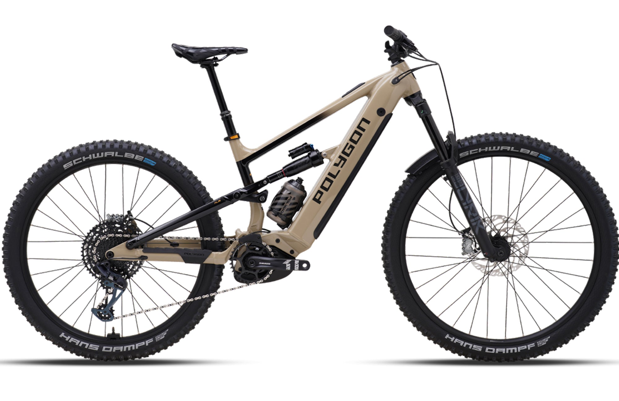

1) The new Levo has a sub 20% progression, so if you want to run a coil you will be disappointed.
2) the new Levo uses a yoke on its shock. Yokes are tough on shocks, they transmit more load into the shock and seals, expect more ware and tear.
3) the Levo suspension design still mounts the shock under the top tube, this kinda sucks if you have short legs. Shock mounted on the top tube means higher stand over, I was hoping they would go to a Status design with the shock mounted on the down tube, these bike have lower top tubes.
4) the Geinie shock is just a bandaid for a poor suspension design. When you have a more progressive suspension design you can run lower air pressures without bottoming out. The Geinie is just a more complicated Float x, what could go wrong with a more complicated air shock….. cough, cough X2 was total crap… cough….
