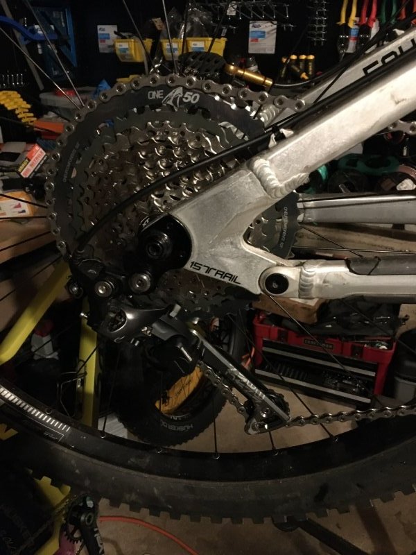

Do you need special dropouts for CK fun bolts? Can't fit the bolt on the threaded side of a ROS9. Took off the hanger to check if it goes through. Way too thin to ride this way
