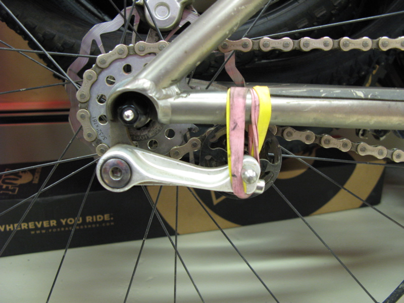

Gearing question - I'm converting my geared bike for the race and have XX cranks (39/26). I can put on the rear is a 15 with a singleator - any problem doing that with chain jump or otherwise? I read on Sheldon that <16t can be a problem as there aren't enough teeth engaged.
Related to that, I may be undergeared as 26x15 is 1.73 ratio; a 26x14 is a 1.86, which is likely better, but has me curious about chain skip. My other option is to race my CX bike with a 24x16 rigid with canti brakes.

The expert class will likely have ratios in the 2.1875 to 1.78 range (with 29" wheels). Since your front ring is small your engagement should be fine. I don't think the CX bike would be good in some of the ST, its fast with some tight turns, depending the steering angle you could be in for a wild ride.

Thanks. I definitely didn't want my CX bike having race Stewart a few times, but figured it might be necessary. I'm on a 29er and at the back of the Expert pack, so may pre-ride with the the 14 and 15 and see where it goes. Appreciate the guidance.
bring heavy rubber bands or zip ties. if the singulator allows it to skip, lash that baby down tight.
Set up the singleator in 'push-up' mode, and you'll get some extra wrap. Add the zip tie to prevent chain slap and you're golden.
Well, maybe not golden, but at least not shit brown.
