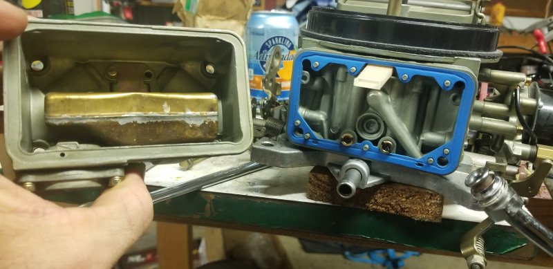

Took the carb apart, rear needle was sticking a bit...
@Patrick problem with the primary not filling was that I didn't realize the process of filling the fuel filter, pump, carb bowls went thru half a gallon of gas.... I am using a can right now as I don't want fuel sitting in the gas tank all winter... So that was easy... Then once I got it running I found the rear needle was sticking. All fixed, running nice now, timing set... No leaks

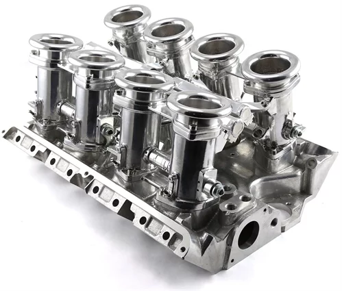

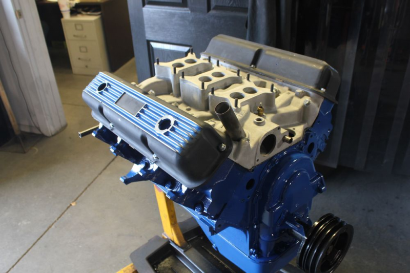

ok, why not two carbs? or 3?
I'm with @Magic here - this always looks so impressive!

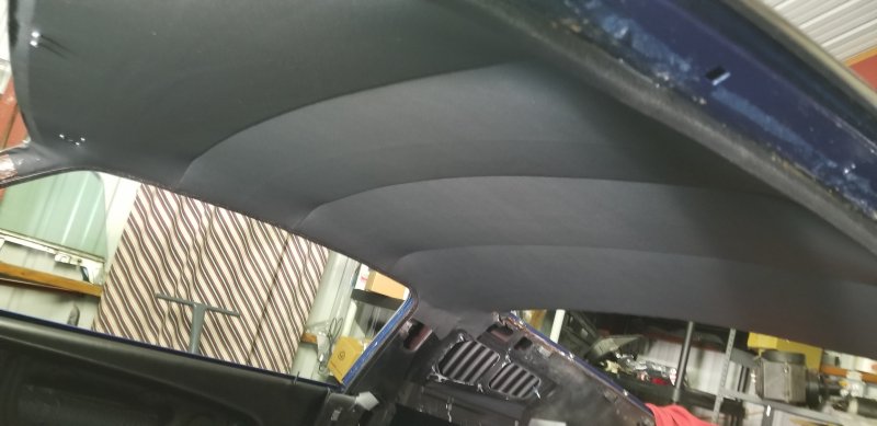

Little more mustang work getting done
The guy I know who did my seats a while back came over last night and did the headliner for me.....I wanted this NICE...thus I had a pro do it

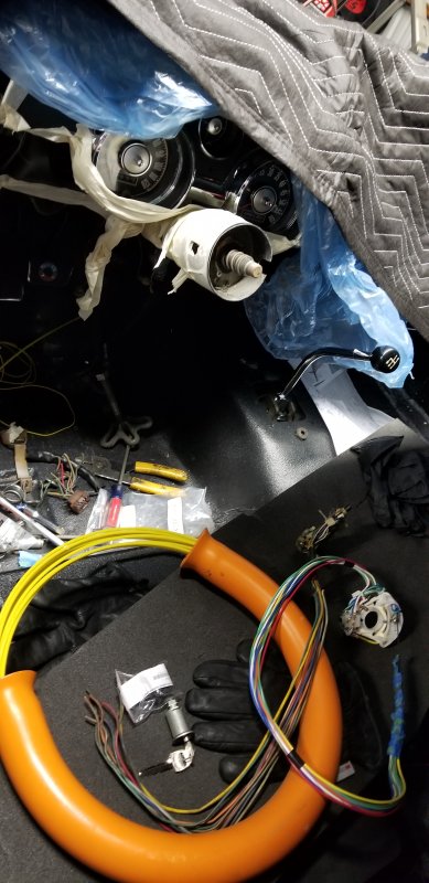

Another...."this should take 15minutes, but fuck its now been 10 days" Replacing the steering wheel/fixing the broken turn signal/horn switch. That is the white disc you see in the picture with the pigtail of wires running from it. its pre wired....so that means I had to cut off the connector from the old one, run the wires out, then feed the new wires thru the steering column. So this is not possible with the upper "hub" of the column on the car...so i had to removed that which was a pain....then I noticed that the bearing the steering shaft rides on was all fouled up....So that needed to be replaced. The steering shaft uses a rag joint on the other end where it connects to the steering box, so getting everything lined up to put back together has been a real party I must say.
