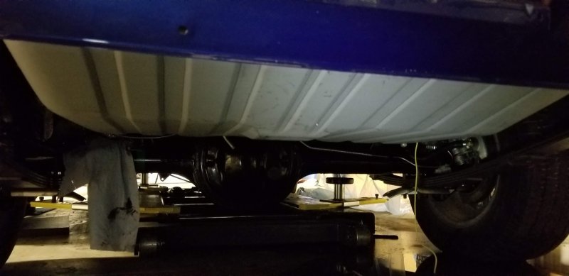

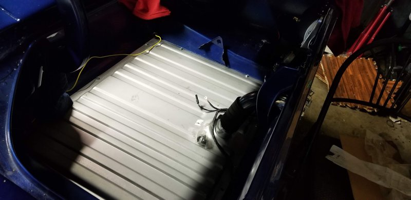

oh I also got the new fuel take installed....which is the trunk floor of a 67 mustang.

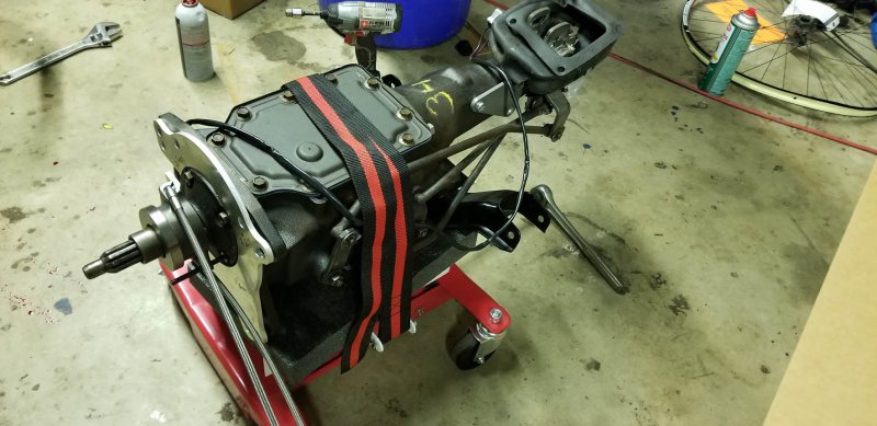

So that was Saturday...Sunday my wife was working all day so it was going to be Bob and I. I got up early and headed out to the garage with the goal of getting the trans in the mustang. After alot of playing with the new clutch set up, I think I have everything sorted now and it should be good....if its not and the trans has to come back out...Im just going to set the garage on fire and move out of the country.

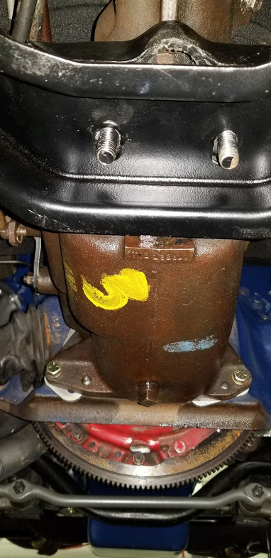

Actually with my little harbor frieght trans jack, it wasnt TOO bad...its always a pain in the ass to get everything lined up just right, but at least I dont have to lift the 120lbs onto my chest anymore.
I cant use the lift with this as its too high and would get in the way of the trans jack, so I had to jack up the car and put it on ramps....Worked out fine, tho I was forced to go back to the days of laying on the floor like a peasant.

Anyway, the biggest pain was the crossmember because of the aforementioned spacer I needed to use for the trans....it fits, but just barely.
So now this is in, next I need to hook up/bleed the clutch and see if it works. Stay tuned.
