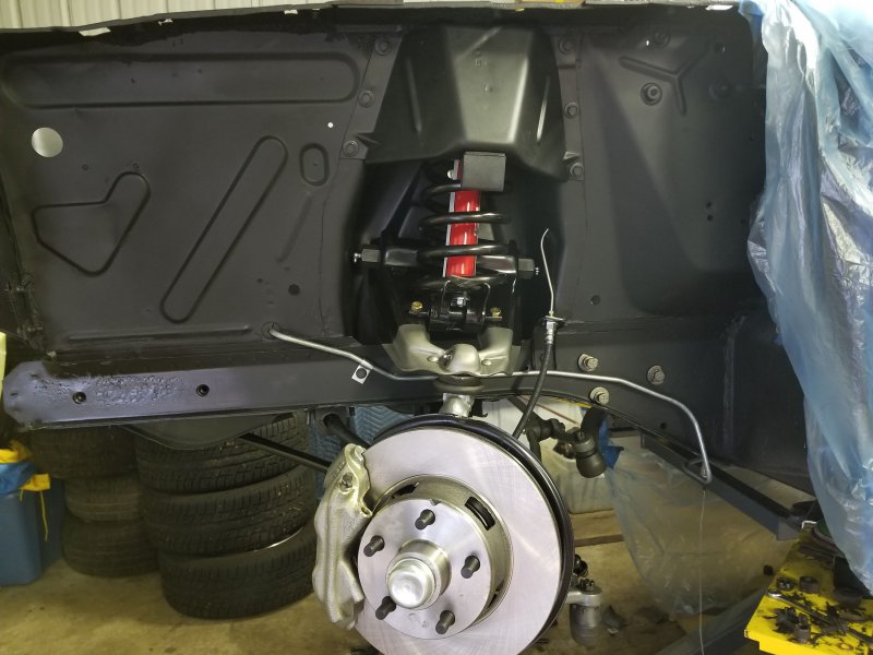

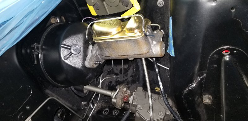

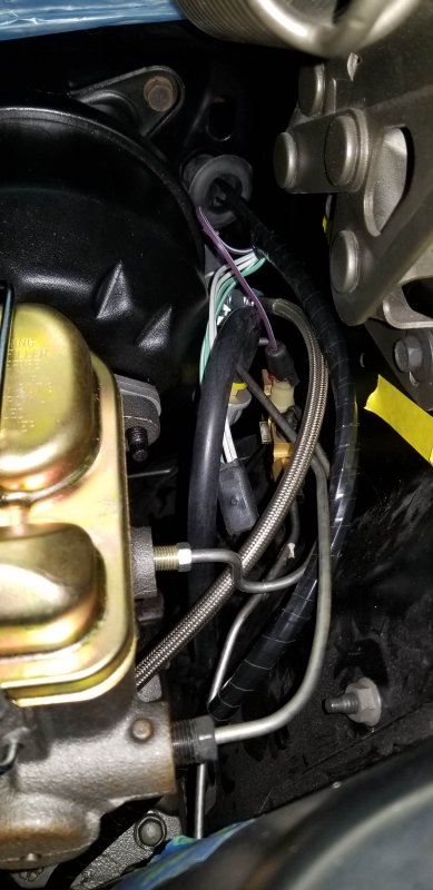

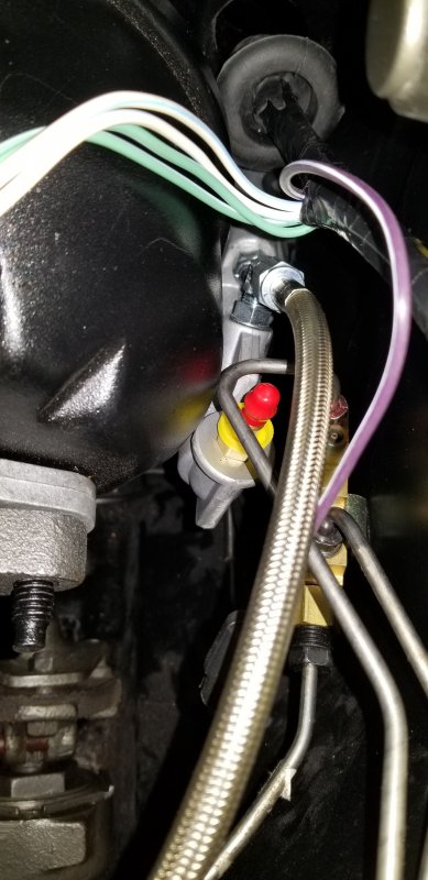

Despite limited time, I have been getting things done on the mustang. 8 weeks since I last posted....When I left I had mostly finished the brakes...I have since finished the brakes. This was not super simple. When I started to bleed the system I found some leaks and had to cut and reflare a couple of things. But everything is good now, brakes are bled and working now.
Steering is also done

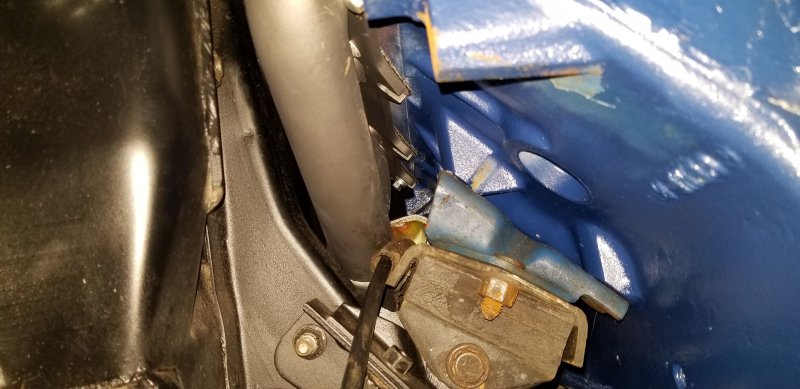

So the next big thing is to get the motor into the car. finally....Its been about finished for more than 2 years now, just sitting on the stand. Its not too difficult to put the engine back into the car, but there is a good deal of prep that you want to do in the case of a 67 big block mustang. As I have mentioned before, this engine is impossible to work on once its in the car, so you want to have any many things on it as possible before dropping it in. The headers for example....390 "GT" engines were not like regular 390s, they used 14 bolt heads and the front and rear cylinders had 4 bolts......good luck installing these once the motor is in the car. I suppose its possible, but even on the stand I need a 3/8" wrench cut in half to get to a couple...heres Bob helping me
After the headers I put new plugs in since that also sucks doing with the motor in the car, few of them anyway.
Next I needed to get the engine off the stand in order to put on the flywheel, clutch, bellhousing and starter motor. In the past I have done this step with the engine dangling from a hoist...It really sucks doing it this way, in addition to it being dangerous...So I bought an engine cradle for this part, it was cheap and would allow me to set the engine on the floor, problem is that the headers interfered with the rear bolts...So I had to turn it around and brace it with some wood. Not pretty, but the engine is now off the stand and onto the floor.
After this, I got out my new billet steel flywheel and got that figured out. It had been since ~2001 since I had to do this, so I did not remember that the flywheel bolts are indexed....meaning the pattern looks symmetrical, but it will only go on one way...so 15-20min of rotating later and i finally got the bolts in
So tonight ill get this torqued down, then start putting the clutch together (after I clean off all of the red grease)
when I bought it I took it out of the box and noticed that it had no coating on it of any kind.... so to make sure it didn't get covered with rust while sitting in my garage I put some grease on it

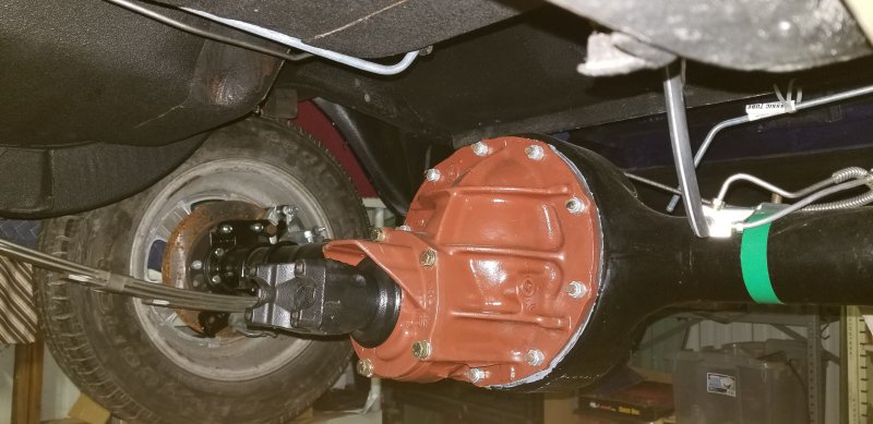

-rearend has been totally rebuilt, new everything minus axles...converted to rear disc and posi

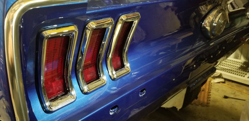

-tailights done (this was a much bigger pain in the ass then it sounds I assure you 🙂 )

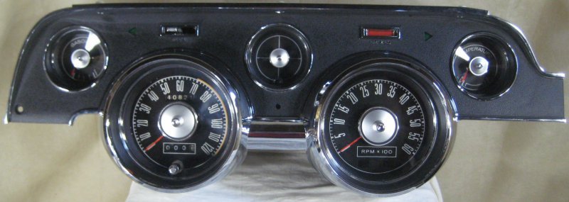

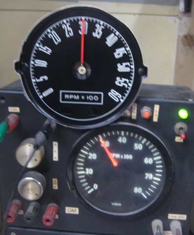

The last pic above is of my instrument cluster. For years now the original tach hasnt been working....These are crazy expensive to replace since the tach is unique to a 67 and they were an option, so they are actually fairly rare...most cars didnt come with them. So I started to look into how to fix this thing and I found this guy....Gary...aka, the Tachman.
So when you are looking to have something like this fixed...this is EXACTLY the person I was looking for.
Is this not the most PERFECT website for a man who fixes old car instrumentation? I mean this might turn some people off, but to me...im like YES...this is the man for the job!
http://www.tachman.com/
These are the old school guys who are dying out but have forgotten more stuff than I will know in 10 lifetimes. While I didnt need this part yet....to be honest, I dont know how old gary is and how much longer he might feel like doing this stuff...so I figured I better get it done. Despite what Garys website might look like, he's an old electrical engineer and technician from back in the day and goddam did he do a professional bit of work on this cluster.
So gary fixed the broken tach, removed and calibrated all of my gauges, reassembled everything with my new lenses
done
