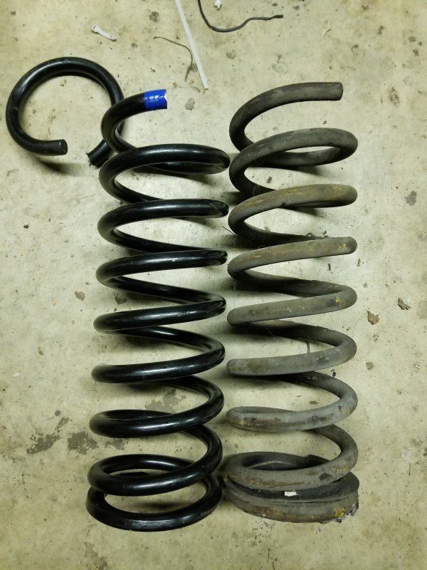

Little mustang update....work has been slow lately, but I got a little done yesterday
This @#$%^&*() springs has been giving me fits.

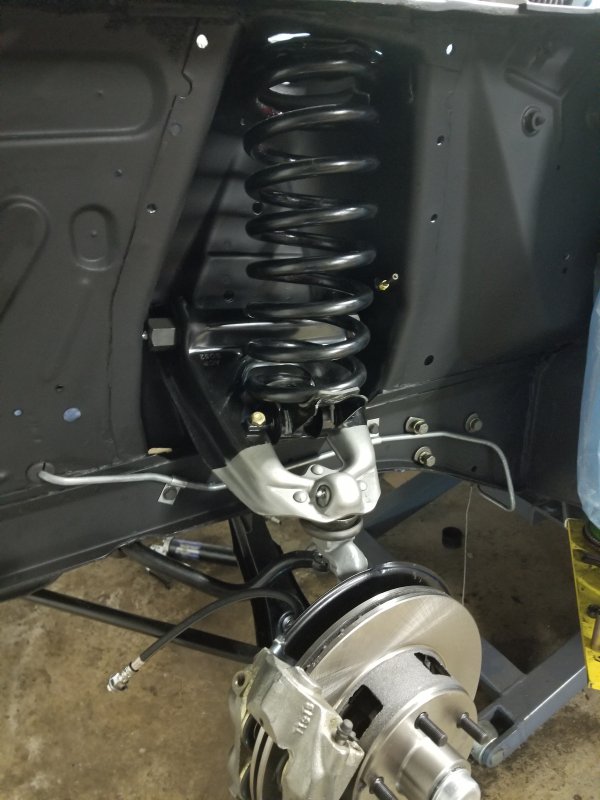

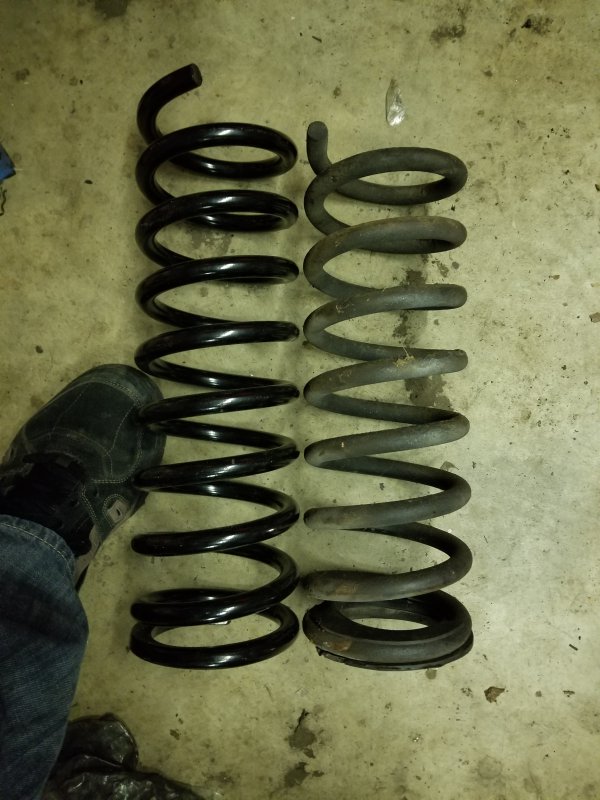

I bought new, replacement big block springs as the spring in my car are original and almost 52 years old now. I called around, talked to some people in the know and found what was supposed to be the stock replacements.....right away I noticed that they are like WAY longer than the originals...which wasnt a shocker, I mean after 52 years, perhaps they have settled a bit

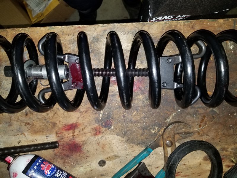

So I bought an internal spring compressor which you need to get the springs into the shock tower....However, I found it was dam near impossible to compress them enough to get them to fit. I did eventually get them to compress enough, but it was terrifying how twisted up they were, both in the compressor and in the car...They were actually bowing outwards which didnt look right.
Death trap 101
So I talked to another guy who sold me the roller spring perches and he gave me a heads up that these springs need to be trimmed....blah blah...lot of conversation about how much trimming later....I ended up cutting off 1 coil.
View attachment 82144View attachment 82145
So then, while still having to compress it to absurd levels, I was able to get it seated without having it bowing outwards.....
So I think this is right, however, no idea until everything is in the car, wheels/fenders back on and I see how its sitting....cant wait!
Anyway, with this done, the rest of the suspension/brakes should be wrapped up soon
Can't wait to drive it!
I had a similar experience when I lowered my s10.. I wrestled with the springs and put everything back together and the front end was too high and stiff. Called the company - they sent me full size chevy truck springs... so I had to take the front end all apart again, put it back together stock and wait for the correct springs.. correct springs arrives, rinse repeat.
The correct way to fix this is aluminum heads, aluminum intake. Then you're down to the weight of a small block.
Then purchase small-block springs. As of now your spring rate is too high. 🙂
The other option possibly is the GT-350 modification to the lower control arm. Then you probably would have a better handling car and the springs would fit...
you mean where you lower the upper control arm 1 inch? That might have helped...but the springs were so BOWED outwards, not sure. I did install roller spring perches on the bottom, which you might be able to see in the pic....This is supposed to improve handling/ride quite a bit. As @ChrisG noticed...the factory coils had 1 less coil than the replacements. Not sure why this is the case. This is where its nice to be restoring an old mustang...many people have had this problem so with a little looking around, I found a ton of information.

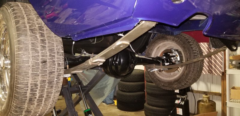

Its been a while since I have done a mustang update hasnt it? Well I havent been super motivated to go out in the garage and work in the cold, but as the temps have come up in the past few weeks, I managed to get a few things checked off.
Finished all of the brake lines for the rear end, then got it into the car.....Wasnt too bad doing this solo with the help of the lift...Although now that it has a posi dif..you can just roll it around...I had to place it on a couple of bin lids and try to slide it into alignment...Lot of moving the lift up and down along with the floor jack.

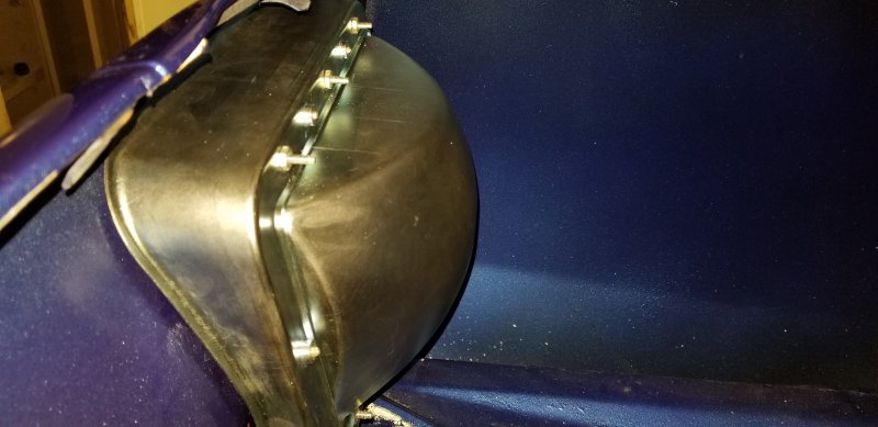

I did the tail lights because somedays you are just looking to go out to the garage and do something that doesnt require a whole lot of thinking or muscle power.....And its something you can just check off....Everything here is new...lens, seals...I tried cleaning up the buckets, but the zinc plating was totally gone so I bought a new set....Really makes the trunk area look nice. The guy who did the welding on my car had all of these parts brand new laying around for years since he decided not to use them on his car....made me a killer deal on everything

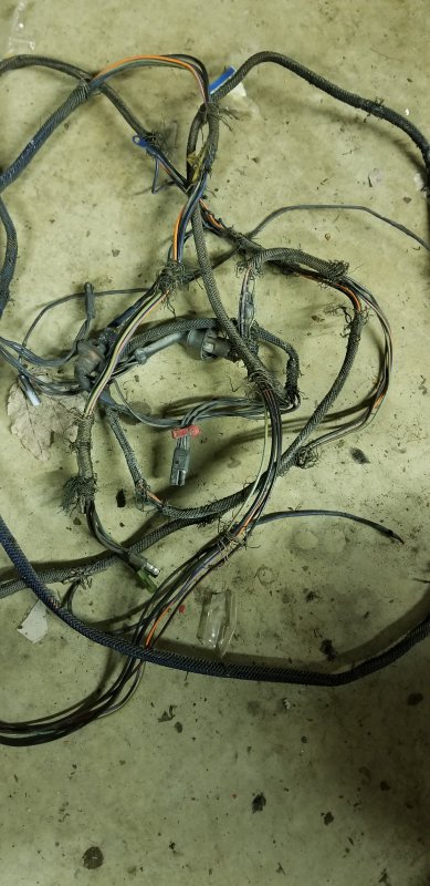

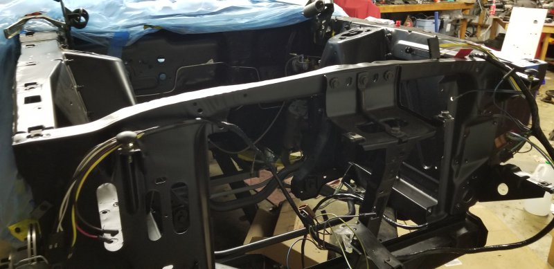

Then I started to put the wiring harness back in the rear of the car....(dash board to rear tail lights)...Then I stopped and was like....wtf am I doing here....Tossed this in the garbage and bought a new one....as with the front. After 52 years, this stuff has had it.
Wiring isnt "done" persay, but its pretty close.

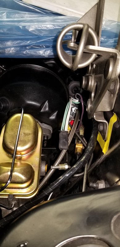

The bigger ass pain is all of this:
All of the brake lines are done....While I bought a pre bent set...It was like universal pre bent...Ala, fits nothing. So everything requried addition bending and I had to make a few other lines.
This spot...You can see the brake booster/master to the left, next to the wedged in the middle is the new clutch master, next to that is the brake distribution block, and also in there is the wiring harness. Every old car is famous for having VAST amounts of space under the hood to work on shit....except this one. Lot of work with the tubing bending, but I got all of the brake lines to fit....then i had to tighten everything in order as I put all of this crap together in the hopes that I dont have to take all back apart for a while....Famous last words...Pic here is before I bench bleed the master and finish up the brakes.
