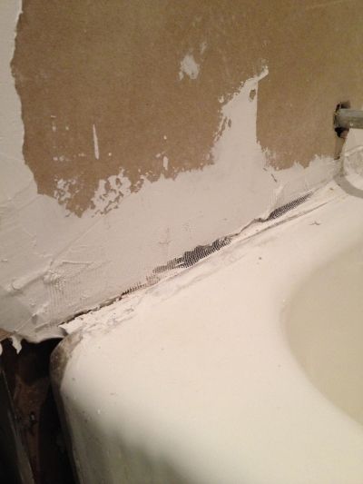

I just posted this in my blog... but this is what they did to my tub. Please, start saying WTF??!?!?! now...
