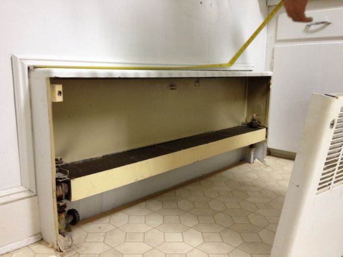

is the "box" of the unit recessed into the wall?
looks like it may come out without disconnecting.....
it looks like the pipes are far enough away from the wall to make it easy -
and it might just be a couple $$ worth of screw on fittings to plug it while 'in-progress'
can you take a picture of the pipes underneath this unit? in the basement....
Yes. Every box we have is recessed into the wall and there's trim around it. We're pretty sure there is no wall behind them... just studs.
I'll take more pictures later today from the basement
so it is recessed 1/2-3/4 inch into the finished surface? this is good - getting easier.....catch you later.
oh oh oh, it's got a shut off valve, that's a good sign, might be monoflo which will make it easier for you to remove.
There won't be studs behind the radiator, I presume almost all of your radiators are under windows? They do this on purpose. It keeps the windows from fogging up, and there aren't studs under a window because the window is in the way of the stud going up to the ceiling. Since the window already has the support built in to delete those 2 studs, the radiator recesses under the window super easy.

AH yes! They are all positioned under windows! That makes total sense. I also know this because of the crack that forms in the wall under the window to the heater. I assume the hot and cold coming in contact pisses my walls off.
