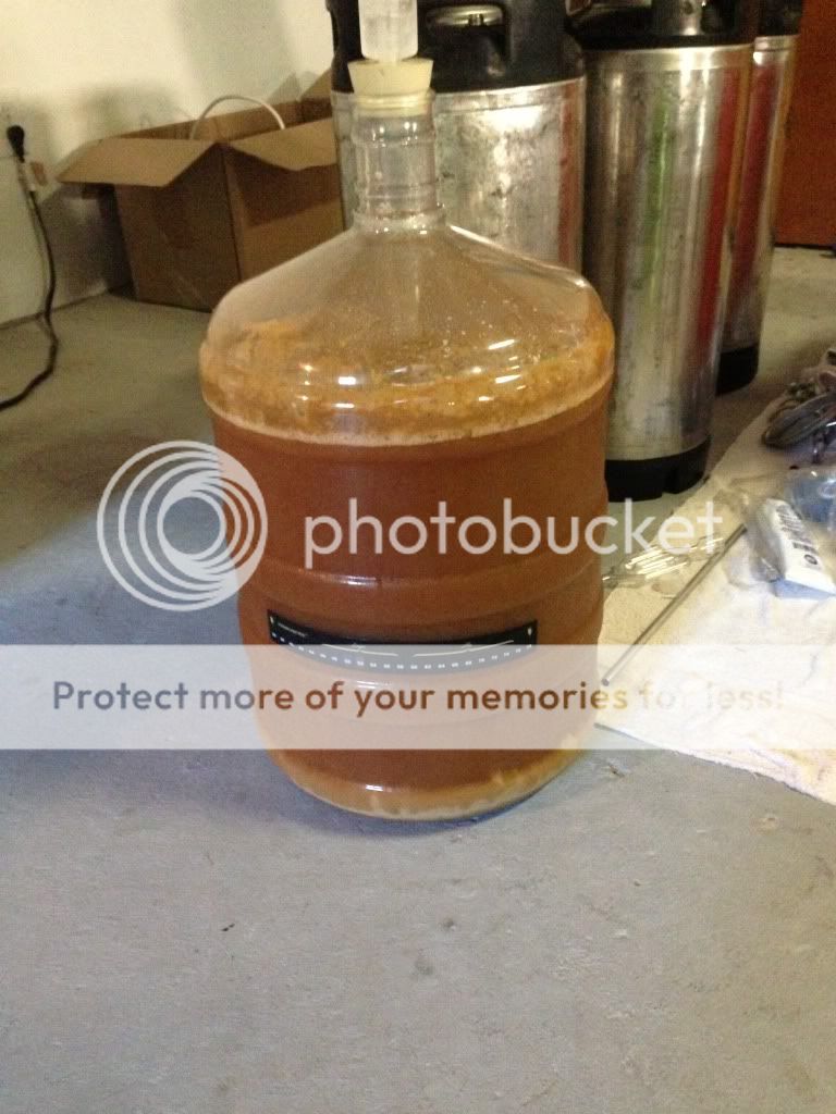

I brewed a pumpkin ale this weekend. Used 5lbs of 2-fow, 5lbs of Marris otter a few ounces of flaked wheat and a half pound of crystal 80. Also in there is a pound each of grade B maple syrup, molasses and brown sugar. I hopped with an ounce each of cascade and Hallertauer. For some pumpkin flavor i added close to 64 ounces of pumpkin puree and three whole cinamon sticks. I double pitched with both S-04 and S-05. This thing took off! Its still going and has an awesome orange color. I'm really looking forward to this in a month or two. Should be around 7 or 8%.
