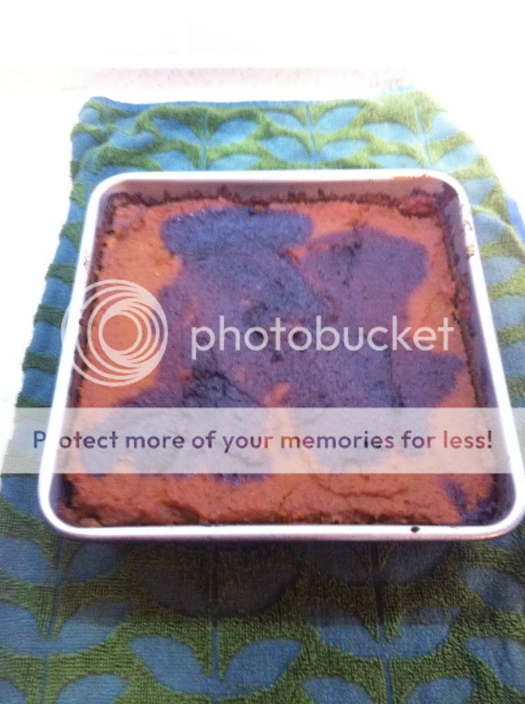

I was concerned about hot side aeration so tried not to splash too much. I ended up with probably close to 6 gallons. Then I put about four gallons back into my kettle and the rest into a big pot. The pot boiled for an hour but I didn't make any additions to it. The kettle got 1oz hallertaur at 60 min, then at 15 it got an ounce of cascade along with nutmeg, 3 cinnamon sticks and some Irish moss. At flame out I added 1/4 cup molasses and 350 ml of pure maple syrup. Earlier I put the two cans of pumpkin in a brownie sheet drizzled some molasses on it and baked it for an hour at 375.Then I soaked the pumpkin in the wort for a half hour keeping the temp between 160-180. After that I cooled. I couldn't cool all the wort down so I put it in my fermenting bucket to cool overnight. I ended up with just shy of 5 gallons of 1.075 wort. I may top up to 5 gallons before pitching or just leave it... I'll probably rack and dry hop around mid September and hope all the flavors come together by end of October for my wife's birthday.

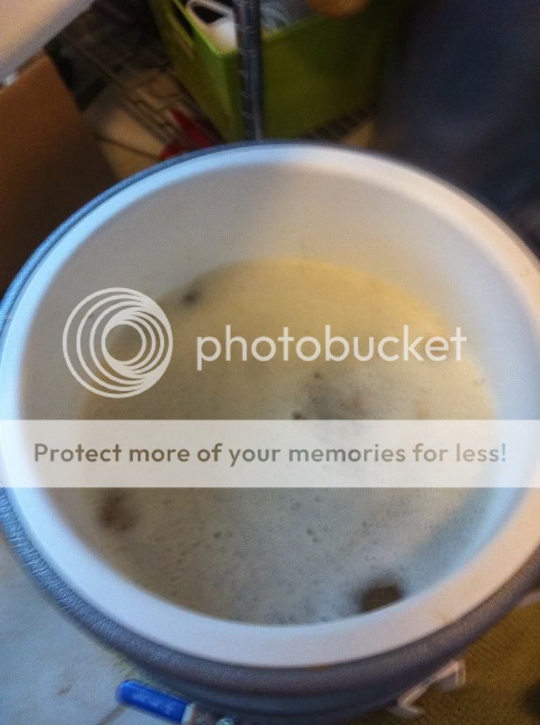

Update: Finally got it cooled to the low 70's so I aerated for a minute with O2 and pitched safeale-04 around 11:15pm. I woke up with the dog around 5 AM and it was bubbling away.

Some pics I was able to take in between steps:
Pumpkin Before
After

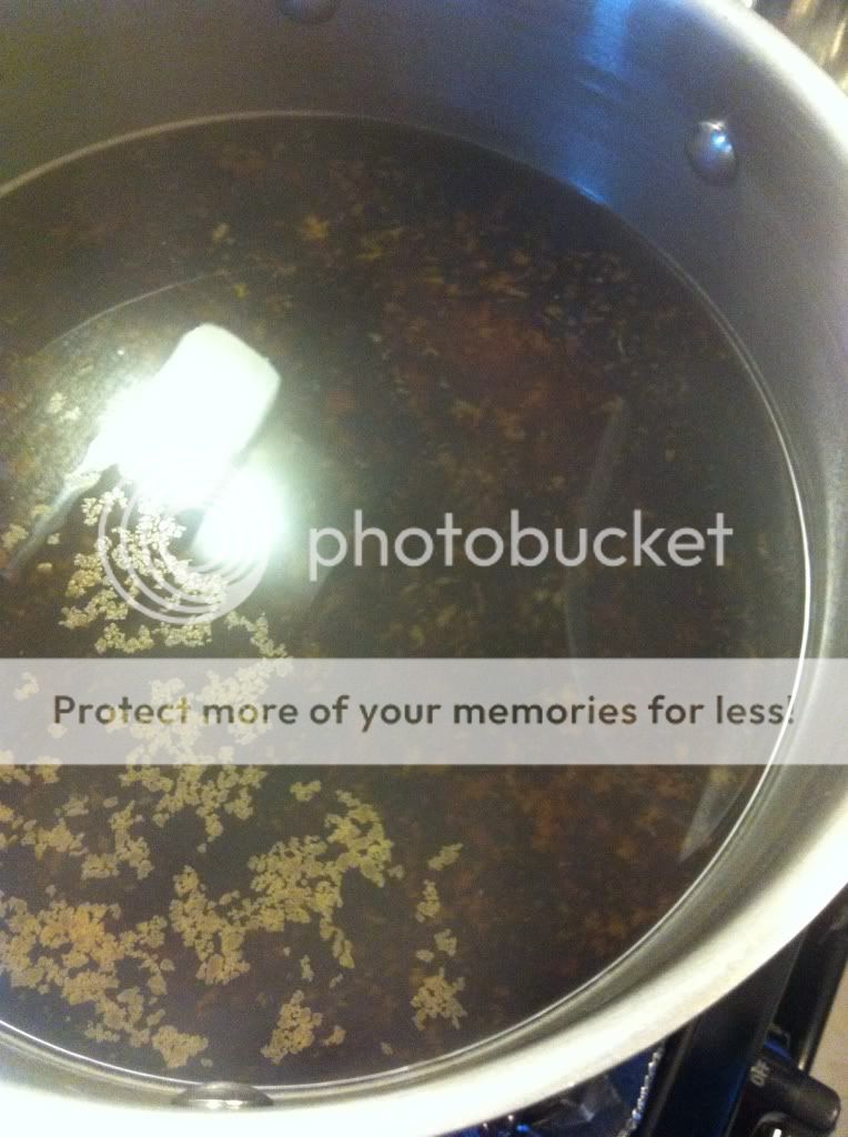

Nice copper color and some hot break
