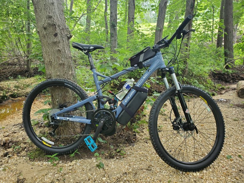

Here's my recent e-bike conversion. It's a Bafang motor kit on my old giant trance. 750 watt motor. Built for the purpose of commuting to work without showing up to the office as a sweaty mess. I can get about a 30 mile range averaging about 16 mph (pedal assist level 4 of 9). Top speed can hit 31 mph in highest assist level, but that eats the battery up quick. Plus, this particular bike wasn't built for speed.
This mid drive is a heck of a lot better than that hub drive I had on this. And it's much lighter.

How does that tire clear the battery at full compression??
It doesn't. I can get about 80% compression before the tire hits the battery. For that reason I won't use this bike for any actual single-track trails. I can still finesse it off and on curbs though.
