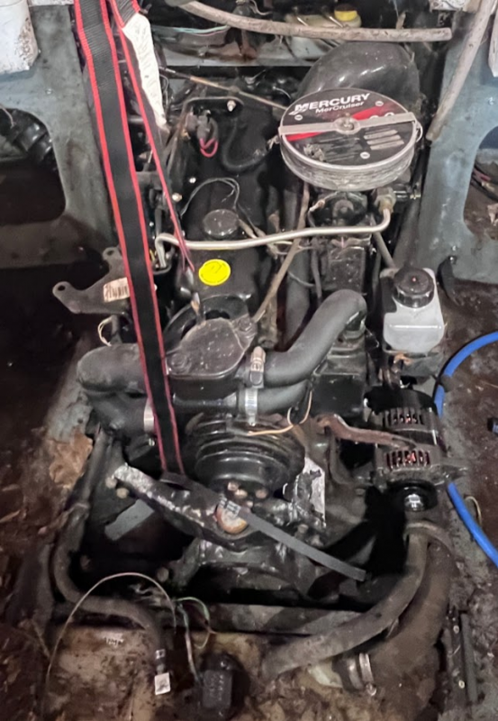

Car you run your truck and put cables on the boat battery to give it some more current?
i have starter spray around - i disconnected the fuel line and attempted to prime it, but didn't work.
It wasn't winterized - I'll pull the pump apart after getting everything going. there is a service kit for $13,
new pump was $38. for the same price, i could have grabbed an electric - then obsessed over the fittings, and routing.
Jumped it to the car - about the same crank speed. big marine battery, voltage checked-out ok.
Don't recall it spinning any faster than what is shown -
I also thought it was throttle body injection, but that is a carb. $150 - I got one coming, hopefully don't need it.
Current one is pretty crusty tho.
And it sounds like it has compression.
@Patrick have you pulled the plugs and squirted anything in the cylinders?
replaced the plugs - probably should have put some mystery oil in there so they wouldn't run dry.
i have a video of shooting air in the spark plug well before removal - big cloud of dust!
