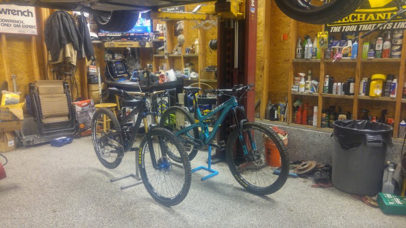

Were you at chimney Rock last Saturday, the turquoise yeti looks familiarDad commented, I've never seen your bikes so dirty for so long. So I took some time and cleaned the new and the old yeti, both View attachment 59257 overdue.
i havent been to CR since the beginning of the summer. i want to get back, i would have gone today but i base my CR report on 6MR reports. so i just ran allaire since you could ride that in a downpour and be ok.Were you at chimney Rock last Saturday, the turquoise yeti looks familiar
