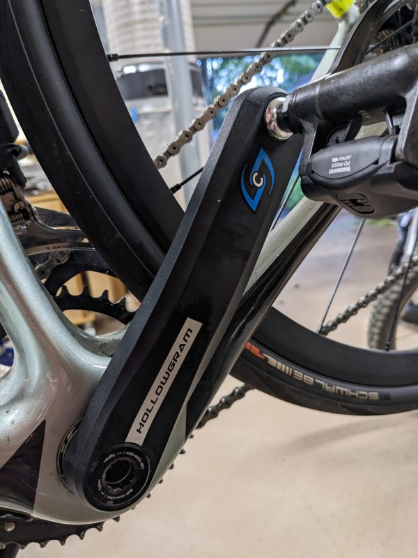

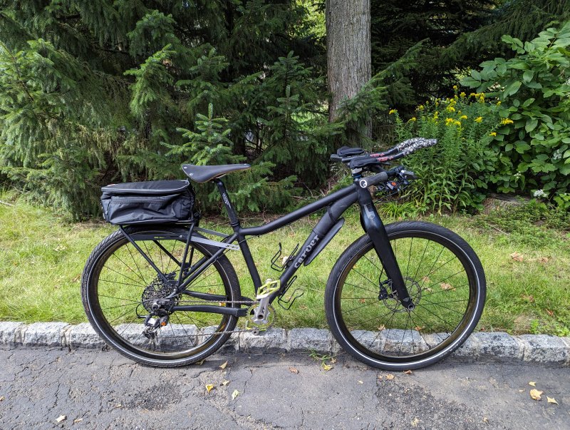

Picked up the Stages single sided power meter. I have an indoor setup with power but I figured for $200 it was worth documenting how weak I am outdoors as well.

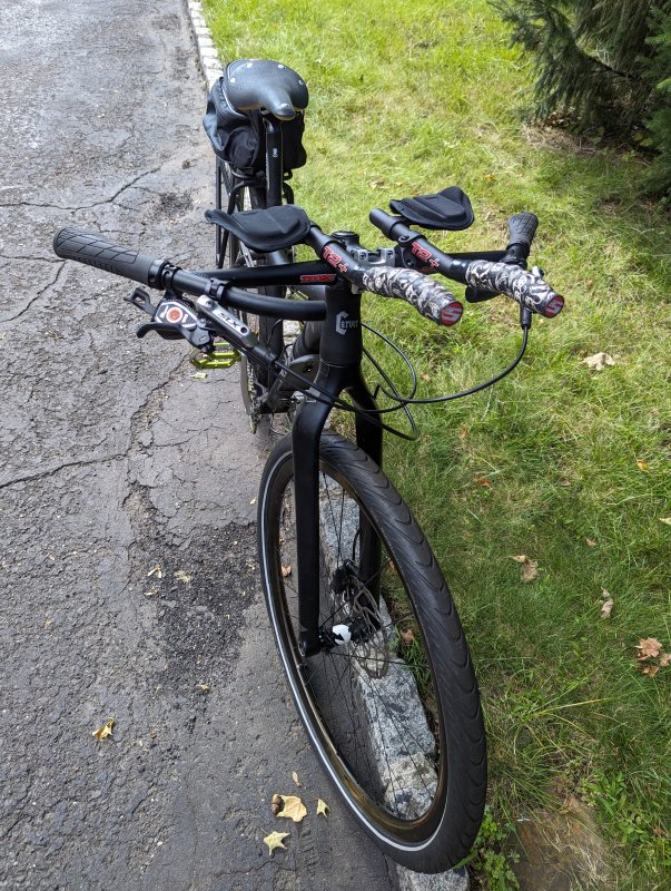

Thanks, all good, the Marathon Supremes are faster than the Conti Top Contact 47mm. Planning to get the Schwalbe Marathon Almotions later in the year. Any experience with them? Supposed to be fast rolling and good puncture prevention
I put a pair on someone's e-bike (tubeless), and they wore them down to nothing with no flats, so...success? The larger size--at any rate--is much lighter than traditional Marathons.
If I wasn't touring, I'd probably still just use Big Ones (G-One now?). They're way lighter, faster, and tubeless sealant for tires that size works well for anything but running over patches of broken glass (or over-achieving seagull litter at Sandy Hook, but I digress).

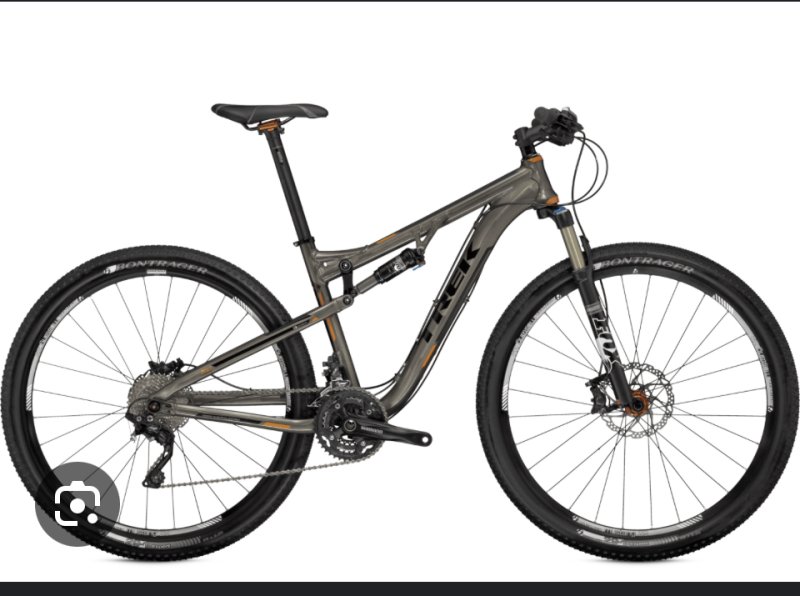

I need some advice. I’ve got a tick/click that I can’t clean up on an older bike (2013 Trek superfly 100 al elite). I’ve replaced the bottom bracket and the pivot bushing on the frame, lubed the seat post and installed a new seat and chain due to normal maintenance. But the click still remains. Swapping the pedals is next. Any suggestions or should I just retire my favorite bike?

You've cleared every possibility of the drivetrain (B screw, cable stretch, derailleur hanger, crank bolts, etc)? When does the click seem to happen? Is it front or back of the bike?

Check the drivetrain: chain rings, cassette and RD pulleys. You mentioned you already replaced the chain.

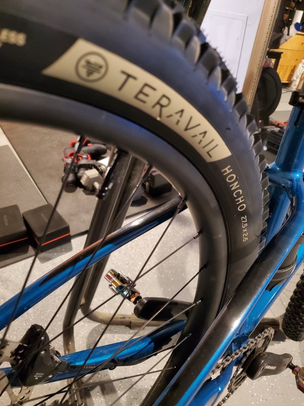

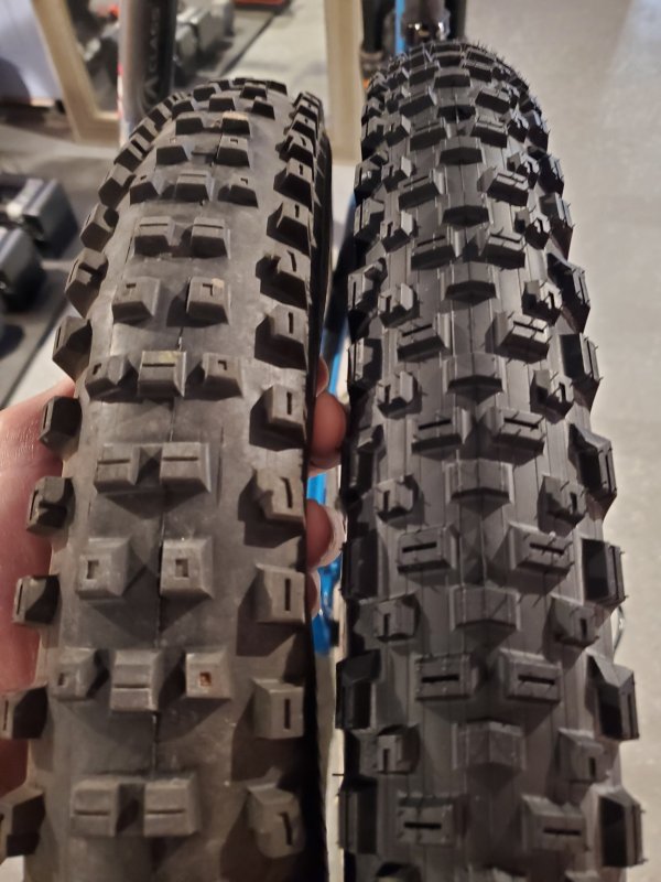

Swapped out the Kenda Hellcats for a fresh set of Teravail Honchos. The Kendas never lost traction but they are a slow roller. The Honchos should speed things up a bit.

It seems to click on the down stroke of the drive side pedal area and only while under pressure, never during light pedaling.

My experience with this has always been the the crank bolts, but I suppose the pedal or BB could be in play, too.

Two things I could think of that you didn't mention one check for any loose spokes and the other is rear hub. Maybe if you had another rear wheel throw it on........
The only things I didn’t notice on a cursory read are…. I don’t remember any mention of loose rotor and or loose caliper…missing bolts. Could it be a cleat issue? Lastly, a possible loose axle. After that, I’ve got nothing.

Ti bottle cage?
Put itt inn the trainer and have someone else inspect

What cranks are you using? I had a similar sounding problem with a set of carbon cranks when the aliminium spindle interface span creating a barely visible crack around it.
