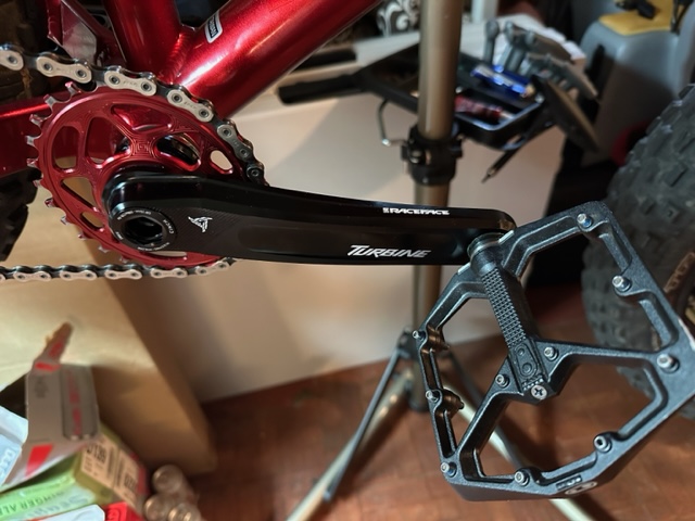

Installed 165mm cranks on the fatbike.
Post up your riding review. What did you ride previously, 170mm? I've been pondering a swap to 160's...
going from 175 to 165. I have been riding 165's on my main trail bike for a year. It feels different for the first ride but not like you lose any power, just feels different. You definitely will notice the improved ground clearance. shorter cranks are well worth it.
The link references a test that basically shows that while there's individual variance, most people won't lose power by going shorter than the standard 170/175. Also, I regularly switch between 165 and 175 bikes and never notice anything. My choice would be 165 max.

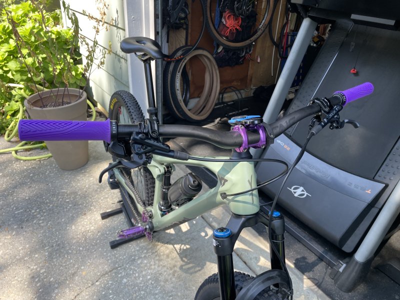

Just finished a ton of work to my trail bike:
New parts:
  • 29x2.4 Forekaster V2 front (REALLY like this new Forekaster)
  • 2.4 Rekon rear
  • PNW Loam grips
  • Fidlock bottle holder/bottle (overrated, would not buy again)
  • Wolftooth light action dropper lever (I really like this over the original)
Parts swapped from my Jeffsy:
  • Nukeproof v2 wheels
  • PNW Dropper & Ergon SM Pro saddle
  • OneUp Carbon bars, Nukeproof stem
  • SLX 4 pot brakes & 203mm rotors
  • Nukeproof Sam Hill enduro pedals
  • AbsoluteBlack Oval chainring
  • GX AXS rear mech
Got to test everything at Raystown last week & worked phenomenally:

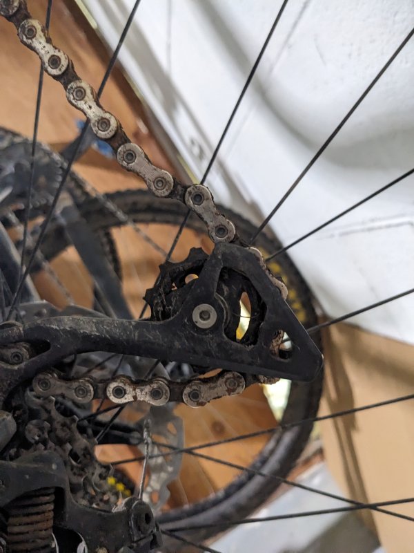

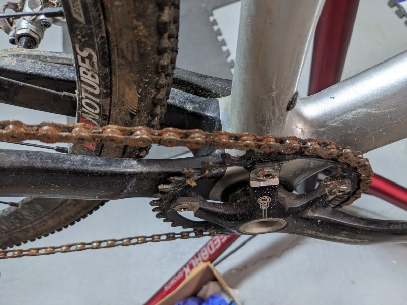

Not my bike. Wife's bike. Was so rusted and stiff I had to break 3 links with the chain tool to get it out. Water bottle bolts thankfully I used grease on them when installing the cages and although similarly rusted they came out cleanly.
Was concerned about all the bearings but everything seems OK including shifter/brake cables. Crank spins better than any other bike in the fleets.
Drove a few hours in rain & salt in February on the highway and then ignored the bike for 7 months...
Good work.
Couple of hours in a crockpot full of wax and it'll be good as new.
Oddly bike is fine. I'm going to say it was the FSA low-end chain just completely rusted like it was below the ocean. Still it's going to get a bath before I put a new chain on.
