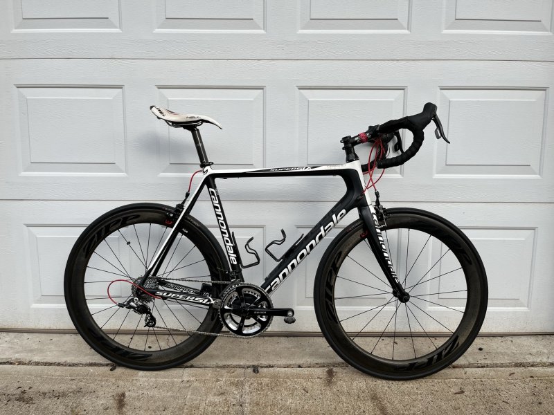

After 31/31 the ole girl needed some love. Took it all apart, greased and freshened it up all around. New Brake Cables, New Brake Pads, New Chainrings, New Cassette, New Chain, New BB Bearings and finally installed the Zipp 404s I bought at the end of 2019.

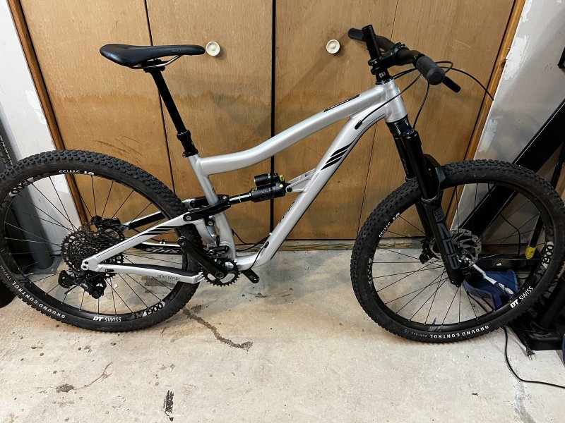

Spent an hour fighting with the derailleur (replacement is on order) to get it to shift right on the Siskiu. Swapped the brakesets (they are brand new), pedals, and seat from the Schwinn. Bled the brakes on both bikes. Spent a considerable amount of time tuning/tweaking the Siskiu. Ordered parts to rebuild the forks (2 years old and appears to have been never serviced) since replacing the forks would have been a pita since the forks are drop out, and the rear is thru +boost so a new wheelset would be needed to keep things matching plus the budget just wasn't there. After finding out the previous owner over tightened everything on the bike (had to replace the rear thru-axle since it was overtightened and stripped) I retorqued the entire bike to spec.
Is the RD trash or could it just be a bent hanger?

Is the RD trash or could it just be a bent hanger?1
The RD looks like it got hung up on something in the past. It looks straight but it's not. More like it got flexed at one time, and was straightened out. The hanger itself is nice and flat. Not a biggie since I am using reward points.
