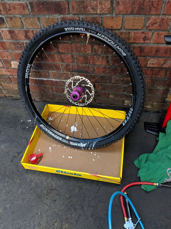

First time in while failure for tubeless. XR4 tires just don't want to pop and seat on the KOM i23. Got any suggestions I can do at home?
did you take the valve core out (i'm kinda sure you did)
seat it with a tube, break 1 side, remove tube, then just seat the other lying flat, using gravity to help?
leave wheel with me for a year or two.
Soapy water the crap out of the inside of the tire and the whole rim first. Remove core and set the compressor to 100 psi (obviously I don't inflate to 100 psi) for volume force. Then use a "tie down" strap wrapped around the tread putting some uniform downward pressure forcing more of the energy outward on inflation. An exercise band can also be used successfully too. That's what I do on stubborn fatbike tubeless tires.

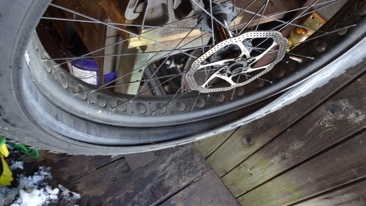

I blow up the Big Fat Larry to 20 psi to seat it and POW, it pops off the wheel!
I lower air and push tire back on and only go to 16 PSI. Looks OK.
Put on bike and lower pressure to 8 PSI. We'll see how it goes.
at 20 PSI

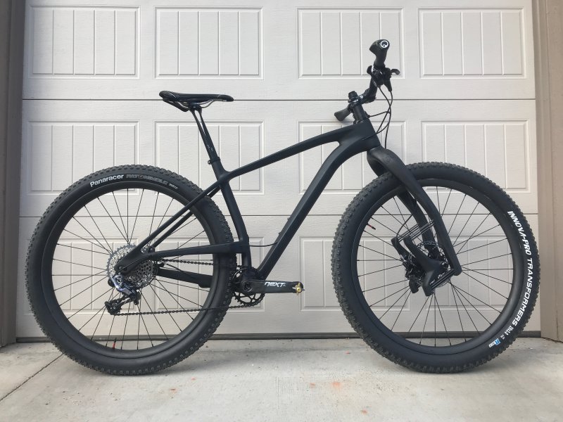

Finally finished it up! At least for now 🙂

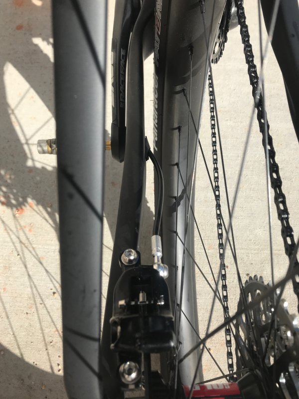

I only road it around the block and a bit on a gravel rode but the ride it turned out pretty much how I expected/wanted. Once I ride it more and put bags, aerobars and other stuff on it I'll cut the steerer and maybe shorten the brake hoses a bit more. The rear brake hose runs internal to the frame; first time I see this.

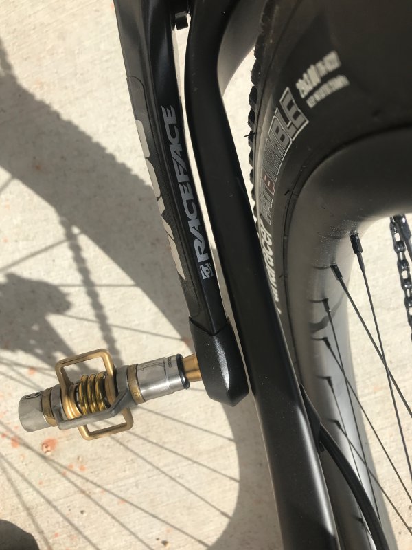

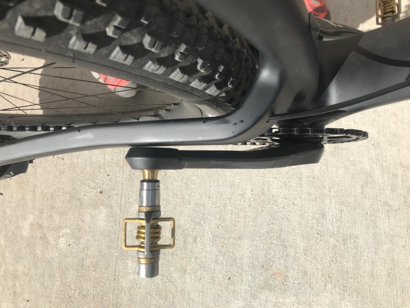

The crank arms run VERY tight with the chainstays (about 1mm). I think with a loaded bike and standing on the pedals, there will be some flex and they will rub. When it comes to that I'll play with spacers or even a longer spindle. That way I might be able to use the Garmin cadence sensor on the crank arm.

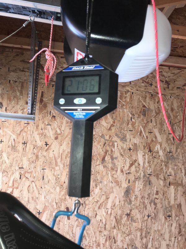

As it is, it weighs 21 lb 6 oz, but that will change once I start adding stuff to it.

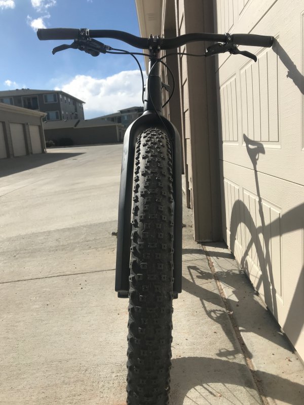

Nice build. That is one unusual front fork set-up you have going on there. Can you post a close up and also possibly explain what is going on? It appears to have some form of suspension.
Yep, as @qlabrat said, it's a Lauf fork. 60mm of travel, no moving parts, no maintenance, relatively light (1 kg/2.2 lb). It's not a replacement for regular forks but very good for the right application. This will be a touring bike and the fork works well to smooth out washboarded gravel roads and other minor trail chatter. I used the original/old version and did well even with a loaded bike.
View attachment 64776View attachment 64777
View attachment 64778View attachment 64779
The one thing I noticed is that at high cadence I couldn't keep up with smooth, "round", pedal strokes (I was bouncing off the seat). I don't have this problem on my FS (Niner RKT). The oval ring doesn't help but both bikes have it and I can do close to 100 rpm on the RKT without problems.

The RF recommended spindle length for a boost 148 bike is the shorter one, (the one I have) with the front ring flipped (I didn't need to do this b/c the chain clears the chainstay well). Their reco's are for getting the smaller q-factor. I might switch to the next length version (+9mm) with some spacers. A $70 mistake...
