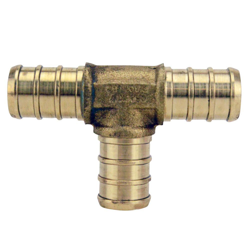

Edit: For example, a sharkbite tee ($13):
A tee for Pex ($3.50):
