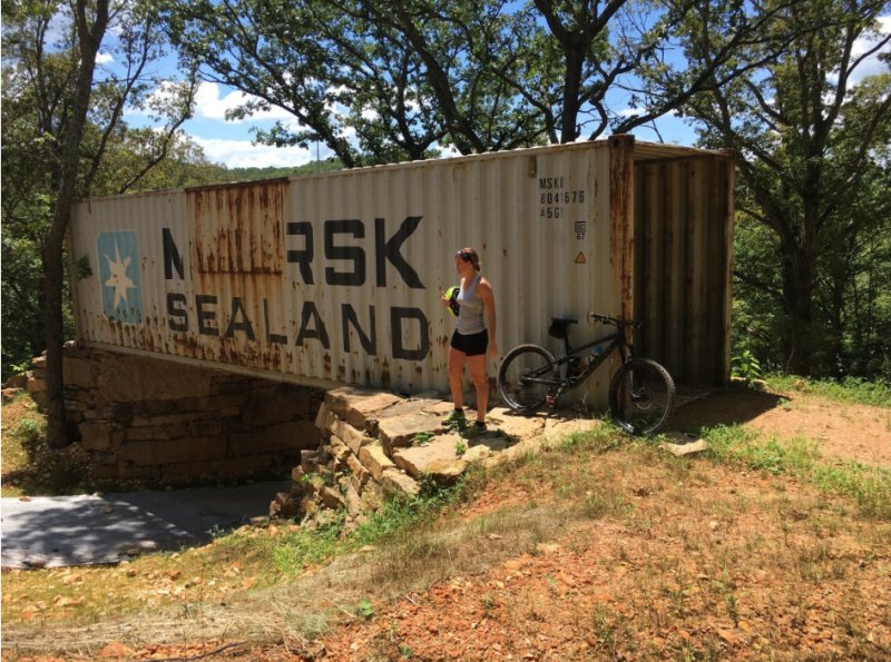

How would the shipping container be installed, in the riverbed on riprap and a culvert, on piles over the water line, or do you have something else in mind?
On two large piles of earth/rock similar to this ‘cept over the water of course.

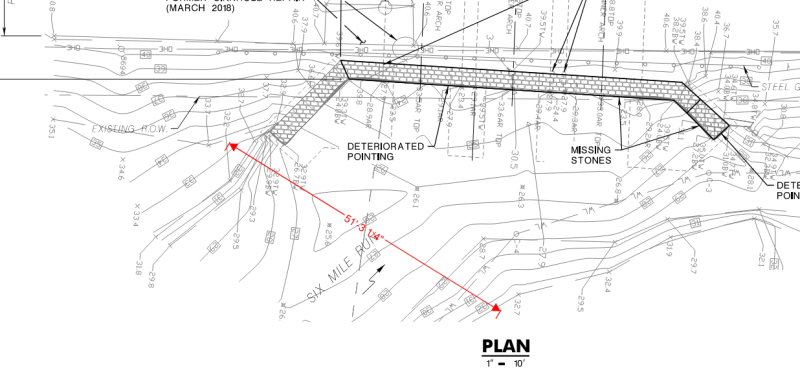

What you don't see here is the elevation drop from the road surface to the bank and its like 50ft to clear it in a dry condition. That entire area is 10-12ft lower than the Canal Rd Lot. A snap shot below is from the plans to repair the culvert that shut down that section of canal road last year.

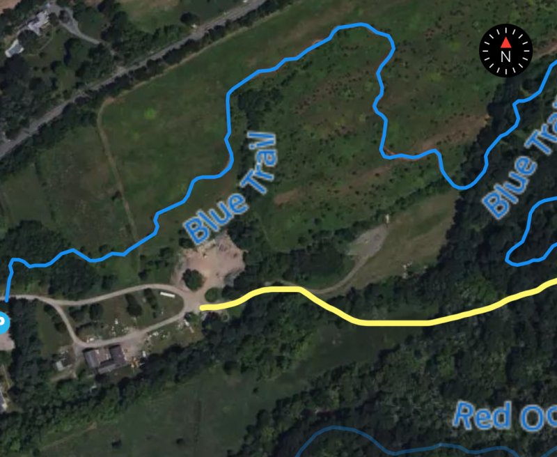

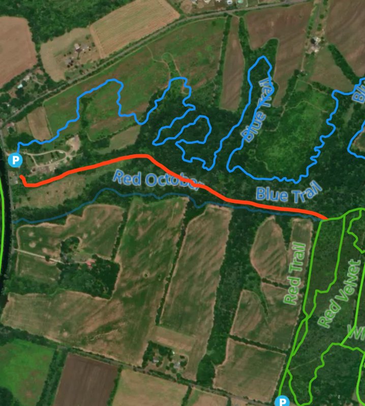

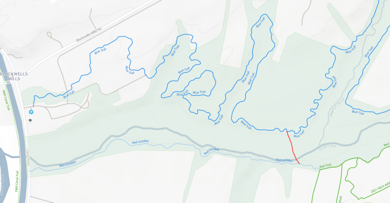

Any chance of placing a bridge there and then cutting a new trail close to Blue so that it is still a loop? Like a dragons neck north of the stream? That would be an awesome opportunity.
Not sure which would be amenable especially not knowing what belongs to the park or what’s private. The yellow would be easiest since you’d basically be riding on the paved/ gravel road. I like the 1st pic route better though.
