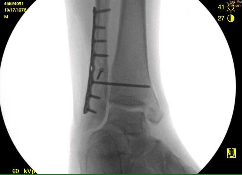

So heres the new erector set....I saw on the list that there were two plates...maybe that just means this one strip is two plates, not sure....I also saw on a list he used 10 screws...but I only count 8...maybe he dropped a couple?
Anyway, what im dying to find out is why does this take 12 weeks of ZERO weight bearing to heal? As in my foot does not touch the ground for 12 weeks....Im not arguing with experts, but im an engineer and I must understand.

Did that one screw miss the hole?!?!

not sure whats going on there....maybe he was just firing screws in....

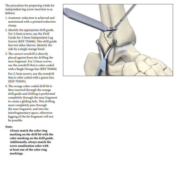

ok so looking at this picture that random screw makes more sense now....I think they put a screw in there first to hold the broken piece of the fibula and line it up...then the plate goes on the outside
