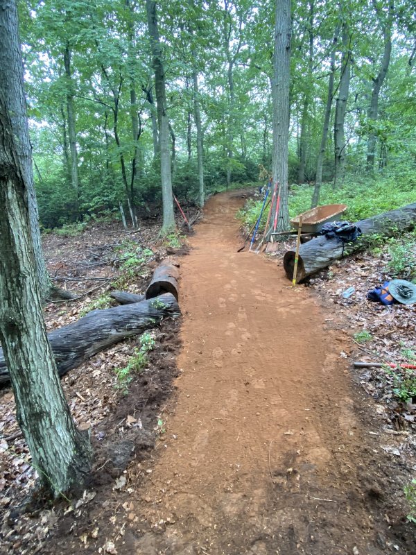

I got to the first shift a little late so stayed and removed a good foot of sand on one of the new corners (close to where it meets by the road).
Shoveling this much run off reminded me how bad the erosion can be at Hartshorne. Things will always move around from use and weather but when a trail has a long run of fall line rain wash builds up speed and takes a lot of material with it. There was a very long (75 ft at least) of thick sand that came from higher up.
The new layout has shorter fall line sections that should shed the water off the tread before it gains a lot of power. Plus carving a turn is more fun than trying to skim thru 8" of loose sand (but maybe that's just me).
And for the comments that the TM crews are paving the place, when the tread is being re-pitched and you are shaping to find the correct grade things will be look way smoother at first. We also add the best material that we can find nearby so the trail will pack and hold that grade which adds to it. Over time and use roots and rocks will appear but if done correctly the trail will shed water and hold it's shape long term.
Props to the crew today for moving that much soil! One off camber section came up a good 2-3' It was some pretty tough work conditions with the humidity!
PS - There are already rooty spots starting to pop through (right before this turn as you come down hill) that will add some technical interest to the line.

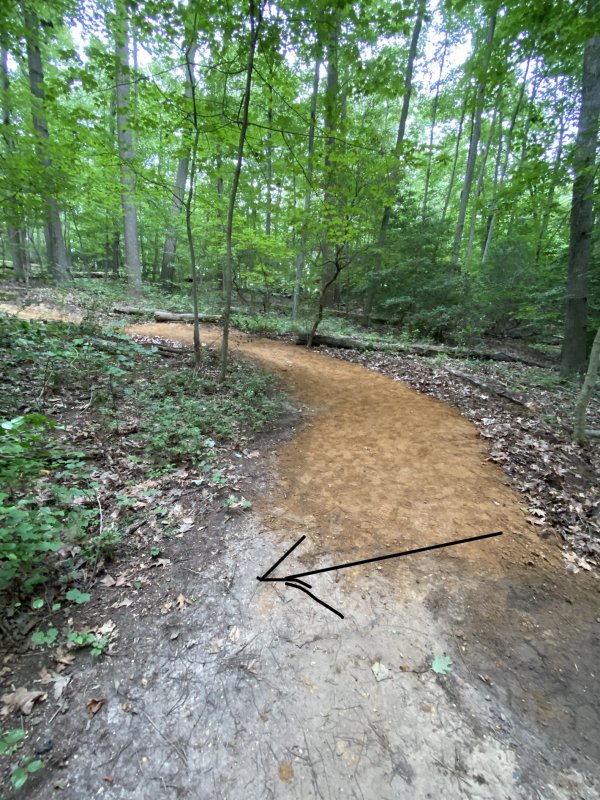

On Monday we fixed one of the turns on the connector trail we had put in several weeks ago, it was too flat, had a roll in it which took weight off the tires and was too tight. We banked it a bit, opened up the radius as well and took out the roll to make for better turning at speed.
This looks subtle but it actually took 3hrs to fix. We build, we ride, we adjust to get it right.

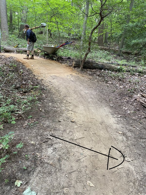

It was a hot one yesterday!

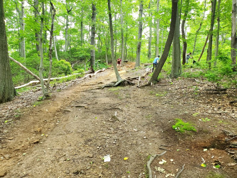

Hare a couple of pics to show the changes. It may not look like much first but the turn was off camber the second half of it and it sounded like the dip rise right before it created an un-weight effect and throwing people off. I personally didn't mind the flat turn but I think the fixes from Monday will help the overall feel of The Connector.
Here is a before and after looking up the trail. Hard to notice but we put in about 2ft of material to the outside edge.
The dip was also removed where Larry is standing on the first pic. That grade went down close to 2ft on the inside edge.
This turn now has a very similiar shape to the legacy turn before it (which formed and developed from decade or so of trail use).

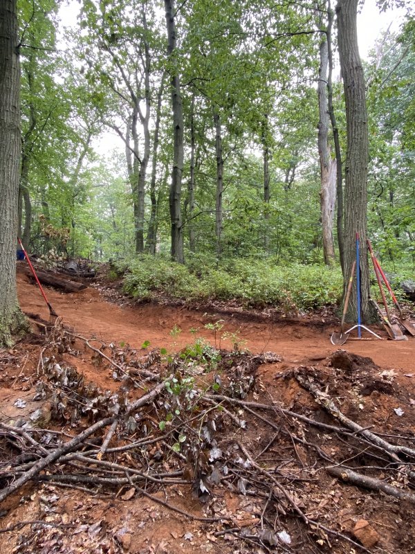

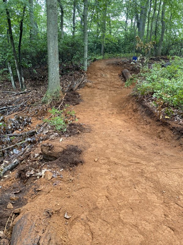

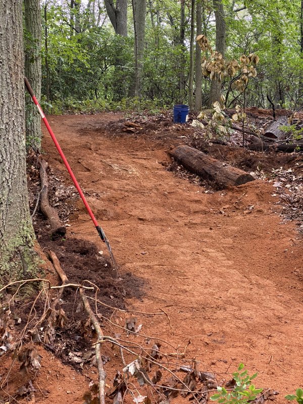

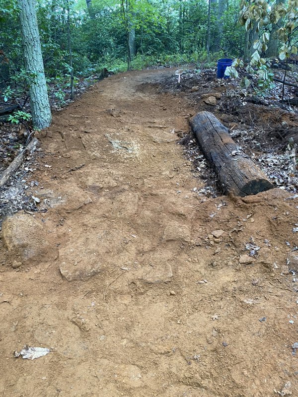

A few of us were back on the Connector this past Monday. We were a mess after 5 hours in misting rain/high humidity but I feel like we made some improvements to the top.
Before and after shots.
We had move some big stone to add stability to a pretty sandy pitch and a little flavor and tech once the material settled in. The problem with the first round of rock was the bottom had none and while the section climbed and descended well it was a little tricky looking and actually wasn't great hiking it (I try and multi-purpose test what is worked on). And there was a go-around being carved in because of the looks and feels.
During the first round Larry and I moved a bunch of big stones to help form a bench. Once the trail path was established I didn't think the trail needed it and actually should go down as a grade reversal. Lots of rock moving between Larry, @knobbyhead and me and I forgot the pry bar like a moron so we made due with the shovels (the Craftsmen fiberglass held up great).
A few more pics. Still a little hard to tell but you should be able to see where the rocks were laid down. We added about 8-10' more of them and it blended the flatter section to the slope better both ways.
We also lined the sides with organics and some small transplants. I know it's the worse time to transplant anything but I like the border and new items will have an easier time getting started in growing with the rich material.
