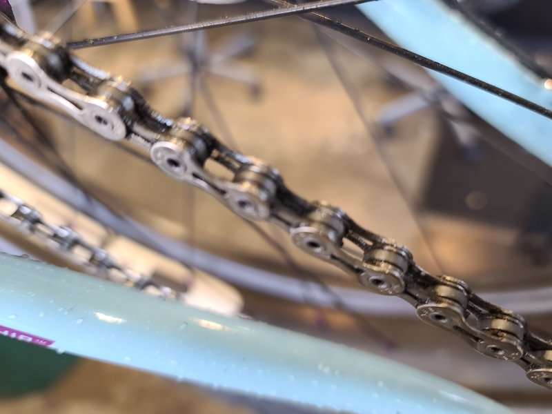

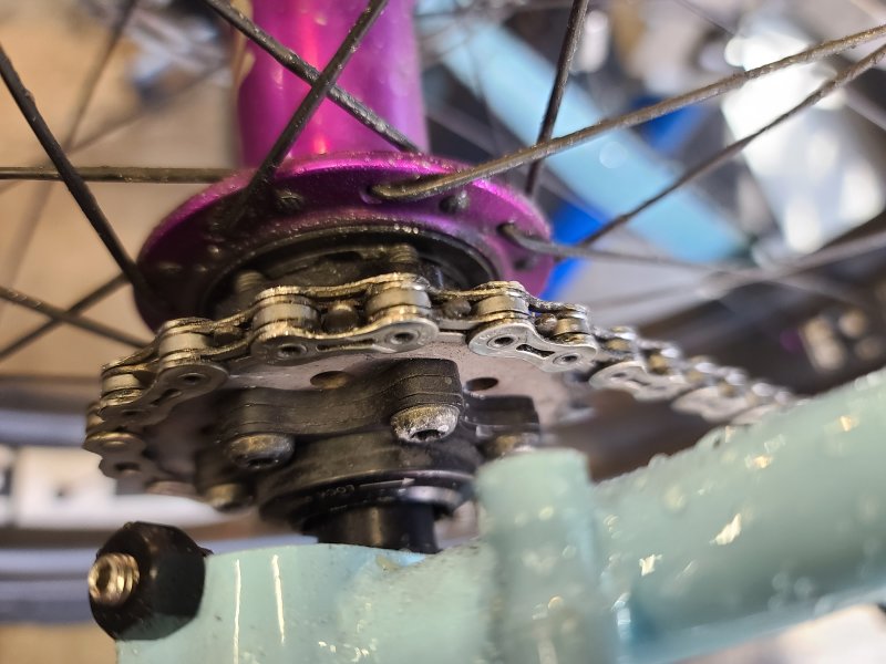

Here's my chain maintenance after 3 rides on the beach (90-miles/12- hours)
Simple wash with a regular ass hose. Compressed air to dry. 2 applications of Silca Secret Lube.
At the same time I reapply T9 to the spoke nipples.
