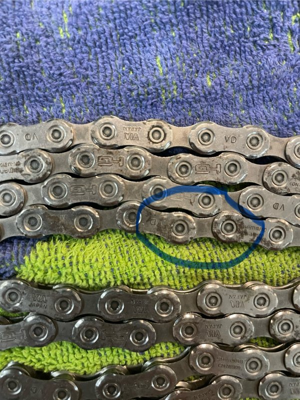

Is this normal (area in blue) after waxing a chain? I tried scrubbing but it won’t come off after restripping and boiling. I wax it back in April. Did I go too long without rewaxing? It was a brand new chain and I followed Molten Speed Wax directions to a T.
Probably or possibly, without knowing how far you rode it or conditions of ride/ storage no way to say. I use the same chain, Silca by the directions plus an additional isopropyl alcohol bath (was concerned about the Shimano chain coating but it worked fine, especially after the second hot wax) and don’t have any rusty chains. I ride where it’s often wet including the beach with salt water. 100-250 between hot waxing depending on conditions, with usually one or maybe two touch ups with the drip on.
Dirty or beach days, the bike and chain get the salt spray/ mud rinsed off, quick towel dry and stick a box fan in front of it.
I had rust from a wet ride where I couldnt full dry / rewax until 8-9 hours after. It isn't a big deal, just surface rust. This has been a rough week for wax because of the wet. I just wipe off and apply drip, the Silca drip wax is dissolved in water, so it pushes the water out when drying.
Two words - Compressed Air
If that's not available then wipe down the chain with alcohol after a wet ride, then apply a light coating and work it in with your fingers. Takes less then 10 min.
