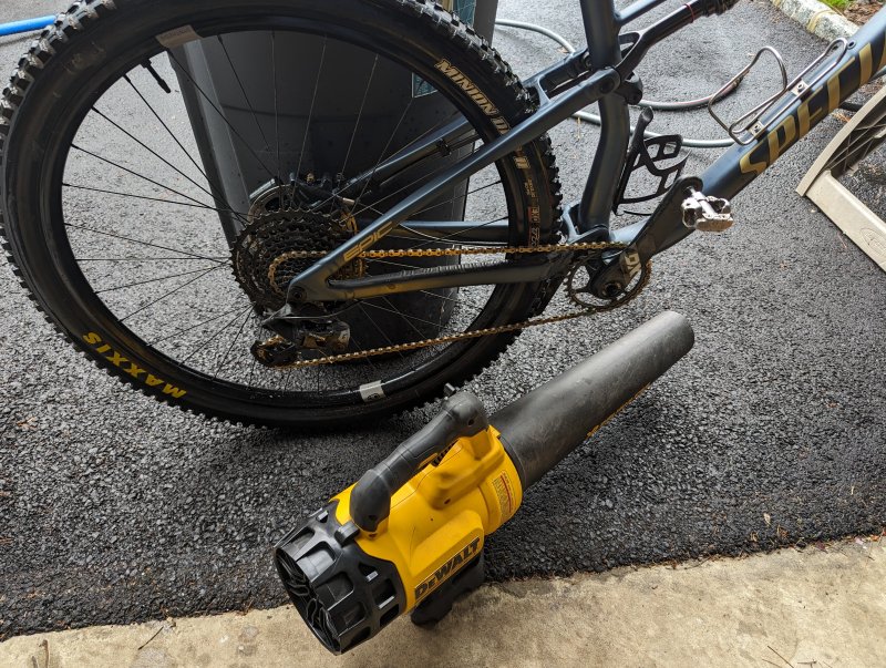

I used my 20v DeWalt leaf blower to dry the chain a few times, seems to work well. Not as targeted as the compressed air but I keep it blowing on the cassette and backpedal a bit and it comes out dry pretty easily. And it's always right there ready to go.
I use my leaf blower too. It works good enough
Same. Works good enough.

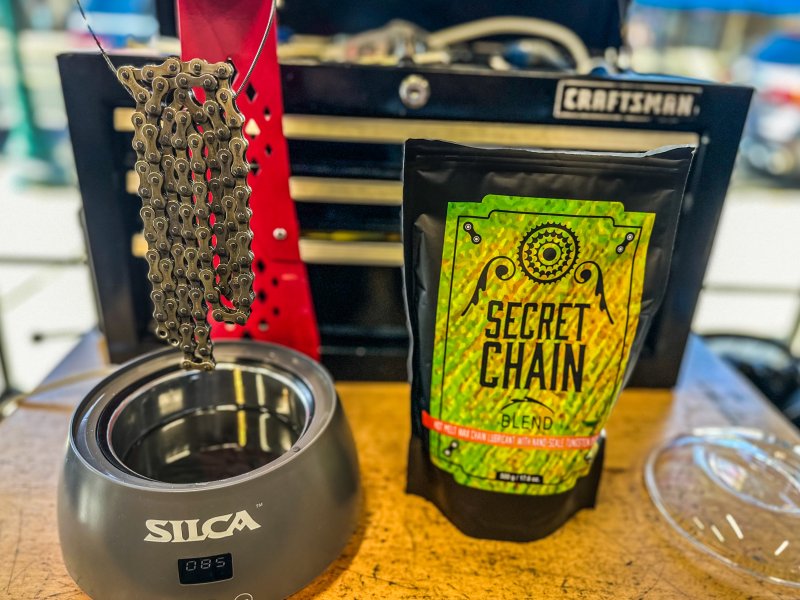

Silca suggests running it through the process twice the first time, and I only did it once because it took like an hour. I’ll do it again tomorrow. It seems to be a billion times cleaner than any pre-waxed home mechanic chains that folks have brought in.
You could eat off my chains.
I have doubts about that Silca thing. I don’t see how it can absorb the factory grease into the wax and make it stick to the chain well, and keep it from picking up dirt. I guess you’ll be a good tester. Although you don’t have a good baseline.
I didn't do the chocalate bar thing, I degreased and ultrasoniced the chain the normal way. I also did my track chain which has never been lubed so it was super clean already. I'm gonna do my Force chain and see what that one is like because that has a ton of miles on it, and it's also a lot quieter normally. The track drivetrain is a bit rackeitty normal.

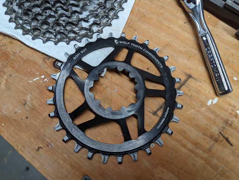

Glad I didn't dump out the ass-end of my used silca chain stripper. I decided to try it as a cleaner on my chainring and it works awesome for this purpose. I didn't take a before pic, but dirty cassette in there for reference to see what I'm working with.
I'm getting the last of my bikes on the wax train and have a good bit of cleaning ahead of me on this one.
