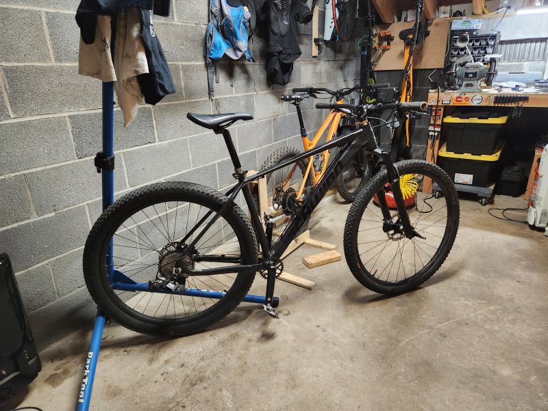

It's not terrible... I might like this.
The 2.25 front looks tiny compared to 2.6 in the rear 😀
Solid looking bike, anyway to change the rear dropouts to TA?
Dropouts can't be changed unless I take some welding classes. I gotta do the end cap thing.
Even with the stock rear wheel on... the bike got significantly lighter. Without measuring, I wanna say it prolly lost 4-5lbs.

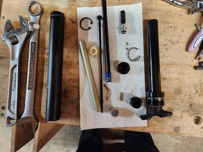

I'm just a cheap bastid and I like the Reverb.
Once I reset the IFP and not pull on the saddle while the dropper is down, Reverbs have been pretty good to me. They are a little slow when the temperature is cold but other than that... great dropper.

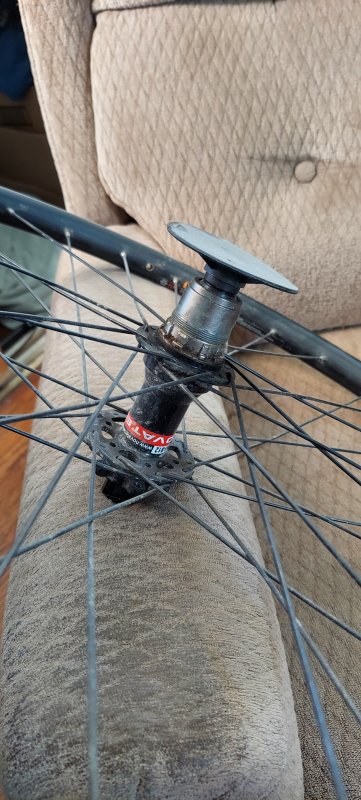

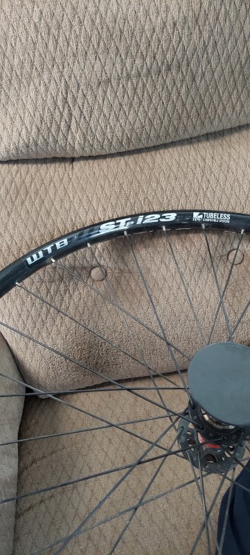

Got the rear wheel from my friend last night but it looks like it has a SRAM 746 hub and I don't think they make end caps for 141QR for this.
Do I want to build a rear wheel as well? Or keep the boat anchor of the stock wheel the bike came with?

I'd say keep the anchor as you may not even keep the bike after a year. Peel off the stickers and make it someone else's dream bike.
