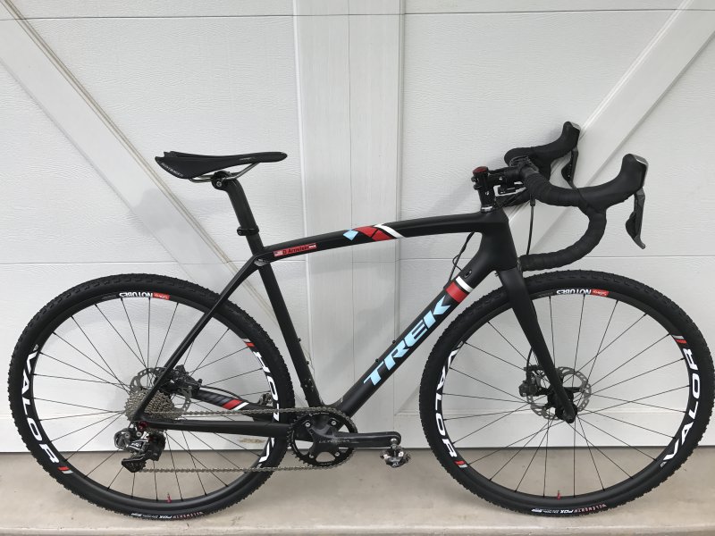

just went tubeless on my Jabberwocky. New Maxxis Ikon and Orange Seal sealant. Also installed a White Industries crankset. First ride was last week at Hartshorne and the bike was firing on all cylinders. Tubeless setup worked fantastic.
What pedals are those?
Also what's your review of eTap?
pedals are WELLGO RC-713 - inexpensive, one sided, spd mtb style road. I haven't picked a road pedal style yet. I may move the ultegra spd off the other bike - a bit more platform, and lighter.
Let me get some miles on etap, and get it dialed in a bit more. Needs some micro adjustments, which i read-up on last night.
First impression of e-shifting: fantastic. the short throw to shift, the alternate paradigm, no micro adjustment. Need to get a handle on battery life. Apparently the derailleurs have a vibration sensor,
so the radio will not sleep if riding around in the car with the bike. Remove batteries for longer trips?
I'd love to get ETap on next road bike... the Di2 on my CX bike is amazing.... I like the swapability of the batteries on ETap if one goes dead. Taking batteries off for car trips makes sense if that is the case with the vibration sensor, since it's so easy to do.
