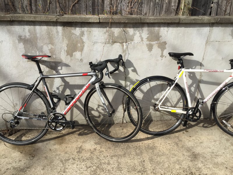

An old pic of my commuter, on the right, for some visual appeak. It's significantly dirtier/more rusty now.
Changing the tube took me 5 minutes, setting the wheel and adjusting the brakes took another 30. Are there any tricks to centering the wheel, tightening everything down, and making the breaks not rub that I'm missing?

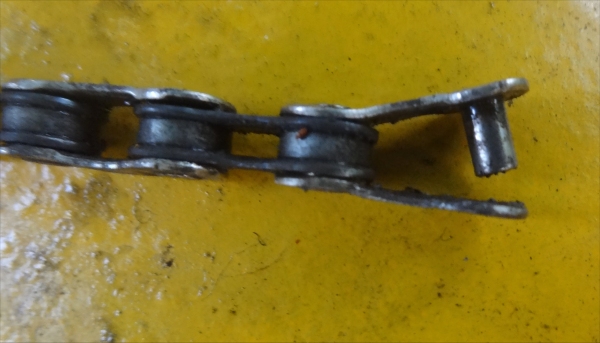

So I rode my Jamis bike just for fun yesterday and it's shifting like crap now! Jumping all over the place.
I stopped on the trail to check it out it was getting so bad.
UH-OH! new chain time
If the chain isn't stretched, all it really needs is a quick link.
I wouldn't know how to tell a "stretched" chain. This is a bike I garbage picked last month and just cleaned up a bit.
0$ invested so far, so I bought a $12 chain and put it on and now it rides again! I'm happy.
