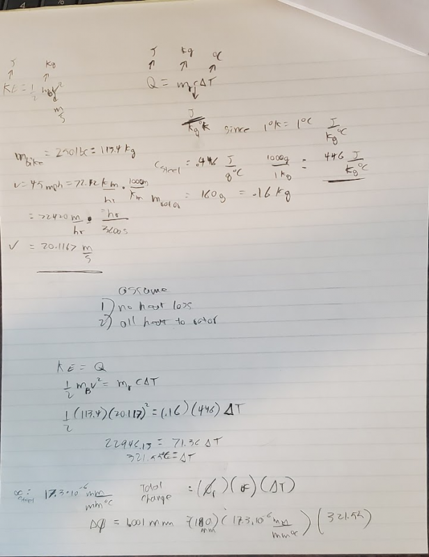

I agree that the differences will be minimal hence my initial statement that two piece rotors don't resist warping(even if the center is a more conductive material whatever interface is between them will likely negate any additional conductivity of the material). Even the floating ones are mostly targeting the caliper/rotor misalignment typically caused by pistons not being truly even in a caliper as it advances the pads(these are even worse for heat transfer since there is an air gap between the spider and the brake track to allow it to float) There is alot of math going on to try and determine that these different designs are better at ______(fill in the blank) but the overall improvement is going to be minimal and likely unnoticed by the rider (definitely in NJ where long downhills are kind of uncommon)
