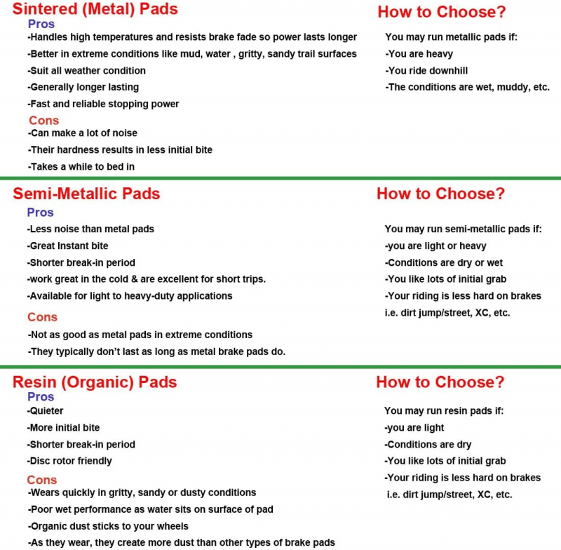

I just changed the pads from resin to semi-metallic (riding in the wet a lot)...hoping this will be a cheaper fix but I fear it won't be. The new bike cost me a lot of cash and initially I thought I'm not upgrading anything anymore but after 200 miles on the new bike I'm thinking that having a dream bike with $hit brakes isn't very orgasmic.
The only thing I can imagine is my fault is that I didn't do that thing when the brakes are new that you ride up and down a hill to heat up the brakes and wear them in. But I also didn't do that with the Shimano kit and it worked perfectly.

Could be difference in brake pads???
this is another point, metallic pads do have less initial bite than resin . . .
My XT brakes have metallic pads (originally resin, which I didn't like) - one of the cons of which is weaker initial bite. My SRAM have been resin until today - one of the pros of which is stronger initial bite. Yet, sram brakes don't have the bite. I installed semi-metallic pads in the front today to test the Sram brakes...let's see
