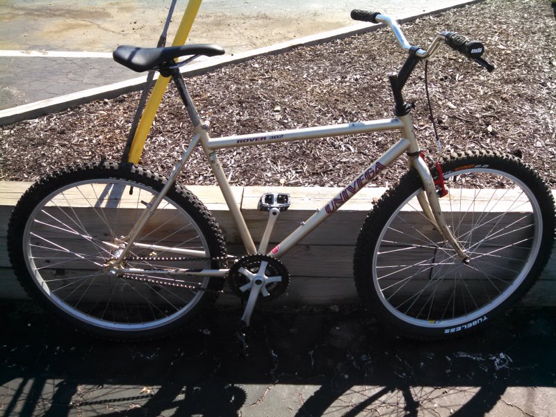

Obsoletely Fabulous, Part Deux:
The Morrow brake is an interesting beast; after entering 'coaster mode', it defaults to being a tap away from engaging the brake, way different from any modern coaster I've used. That also means I have to pedal forward 45°(!!!) before the driver engages!
Also, even though the current crank is just a proof of concept for myself, my god, 39x16 is way too high a gear for me.

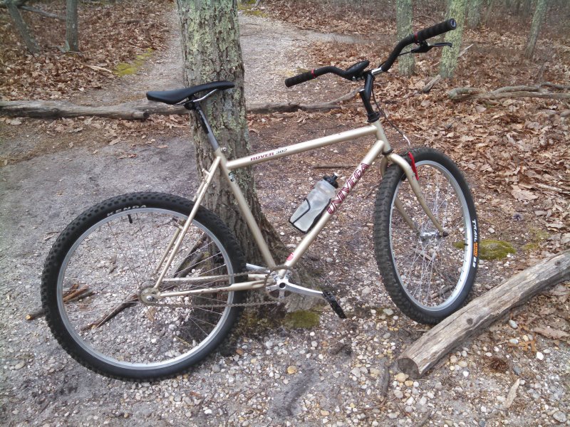

Obsoletely Fabulous, Part 3: It Lives!
With the gearing dropped to human levels (and finally having a lockring for the sprocket), the bike has come alive. It was surprisingly easy to get the hang of using [only] the coaster brake on trail. If anyone else gets a wild hair to try something like this, I found that, while you get the best braking leverage at 3 and 9, it makes sudden drops/obstacles dangerous, as you have no room to reposition the pedals for a safe landing. I got bucked not-quite-off the bike a few times by log-overs, when I inadvertently actuated the brake shifting weight over the log...it was not a pleasant feeling. By the end of the ride, I was doing 2 and 8, which gave me wiggle room to deal with the unexpected. The braking was still sufficient.

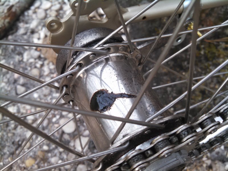

Interesting note: the vast majority of the Morrow hubs eat oil, not grease--I have a use for my 3-in-1 now!
It still got hot-to-the-touch even at relatively flat Allaire, but I never experienced any fading/grabbing.
