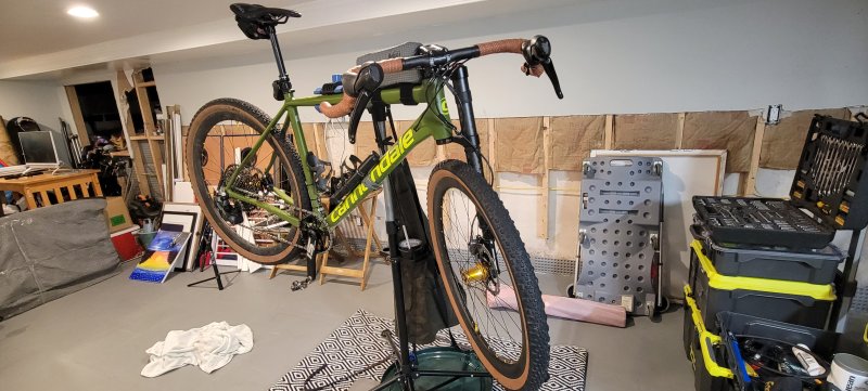

Went 1x AXS on the gravel bike (all the cool kids are doing it)
Also: wider shallow-drop bars and a shorter stem.
I have 1x 12sp axs on the new to me gravel bike.
It’s my first bike with electronic shifting and I’ve got a 10-50 on the back makes shifting and hill climbing much less complicated.
Properly dirty ride today.

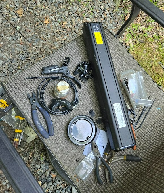

I had a number of projects going on this weekend....wish I took more pics, but my hands were usually dirty.
First up was my Scalpel SI race bike....I found a very small crack in the frame a few months ago...cannondale sent me a new frame...I have been slowy been rebuilding it...finally finished that project (needed to get the brakes bled and the drivetrain finished)....Planning on selling this bike soon as I just dont ride it much anymore
Then my sons cannondale habit LT...Which I love and I think it a great bike for him....however, we trail ride alot and its almost 32lbs, so I wanted to lighten it up for trail riding. I got him a lighter set of wheels, and some lighter tires....My ebike came with all of this fancy XTR stuff that to me is kinda silly on a 50+lb bike anyway. So I swapped out the brakes, derailleur, shifter from the ebike onto my sons bike....which was pretty easy. Running the brake line back thru ebike frame was fun. Made much easier once I popped the battery out. Im at my lake house right now, so I dont have my shop....thus im working outside on gravel like its the 1800s.
