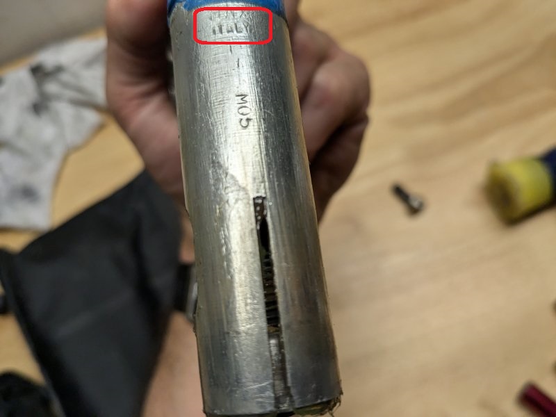

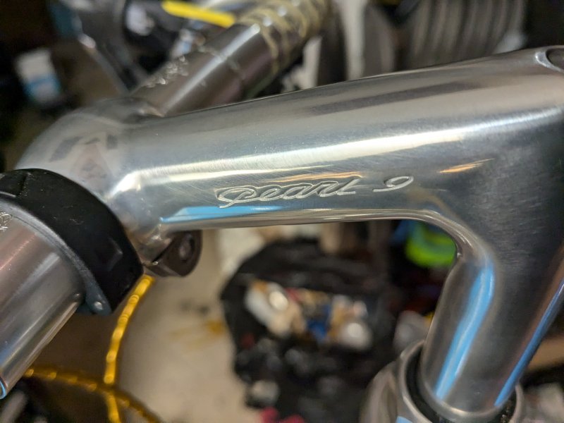

I'd been getting disconcerting creaking from my stem. I pulled it, threw a light coat of grease on it, and put it back. It came back 3 days later. I decided to ditch the "death stem"**, and get a regular quill.
Period-correct stem, only a few grams heavier than the 3TTT. I put on some temporary bar tape, since I wanted to ride tomorrow, and my replacement tape (stay tuned) won't be here until Wednesday.
**Fun question to weed out the engineers from the rest: what's wrong here?**
The OD of the 3TTT stem is too small for the ID of the steerer tube? And by too small I mean like a thousadth from use and removal and installation.

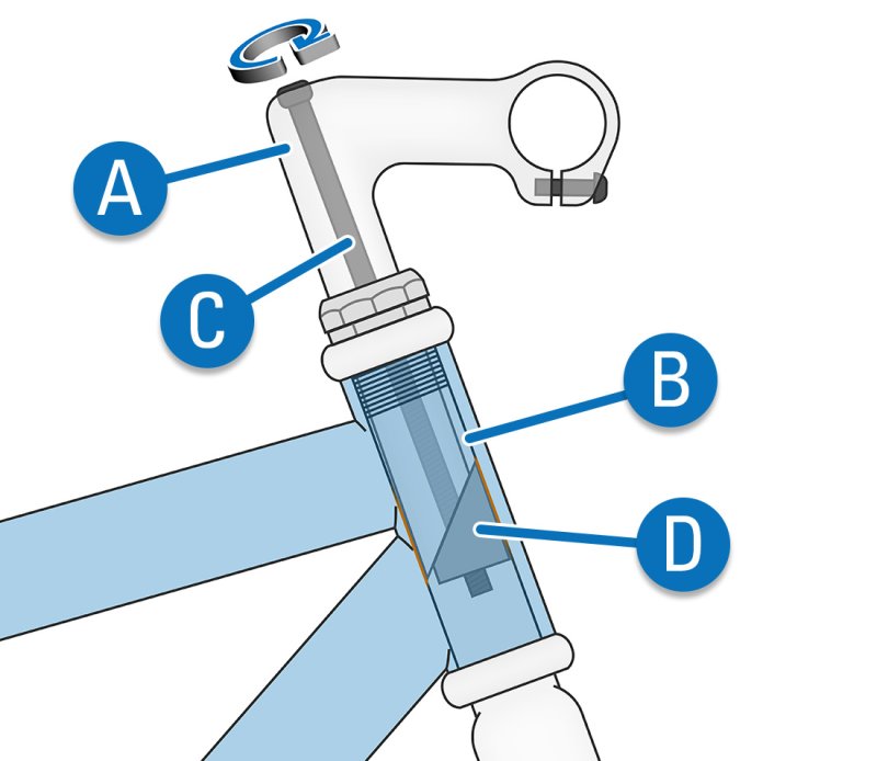

A regular quill design puts the stem shaft to one side while the wedge is on the other:
Side question: why have a negative rise stem if you are going to have it out of the steerer tube a couple of inches? I'm sure that extra leverage has an effect on the creaks.
Pic is from installation, it's going down, just like the 3T.
Expansion slots on the stem are not radiused at the top. Cracks from the stem flexing and being installed/removed propagate from the sharp corners.
The design works 'okay' enough to hold under normal bumpy conditions, but is definitely looser than a modern shop would let out the door.

Here's your problem, in the red square...
Which is because...
That was the first thing I noticed as it's the same for the top of seat tubes where the clamp is but I didn't see the crack (thought it was grease smear).
The 3T has to feel pretty loose - there is only forceful contact on that one inch section of wedge!

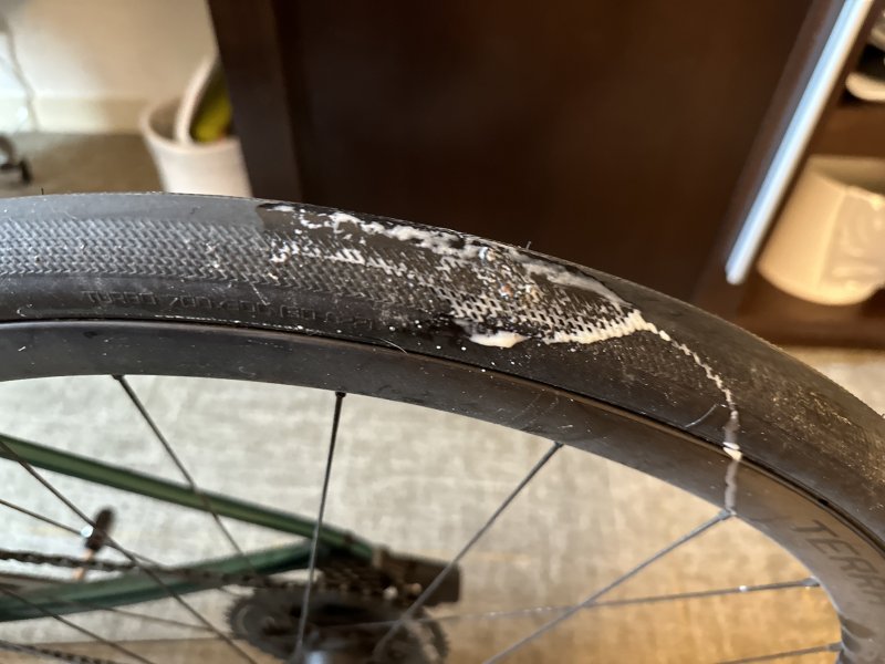

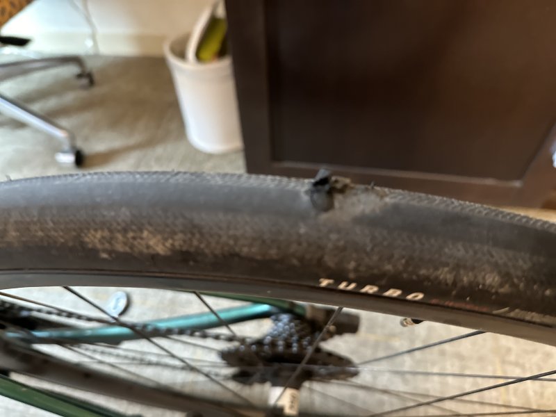

Back at the shop, so this afternoon I swapped tires to the 38s and cleaned the sealant off everything in prep for another adventure. I got 1 flat the first day, a torn sidewall that required a boot and tube. Then the 4th day I got a tear in the morning that just needed a Dart, it never lost air or sealant. Then at the end of the day right outside the hotel I got a 2nd flat but was out of Darts and Co2 so I just left it flat.
And then…
