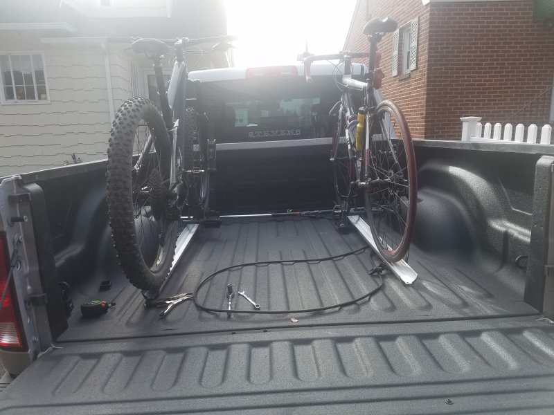

built myself a new rack setup for the bed of my truck, now i can carry multiple bikes without them banging together or laying on top of each other.
