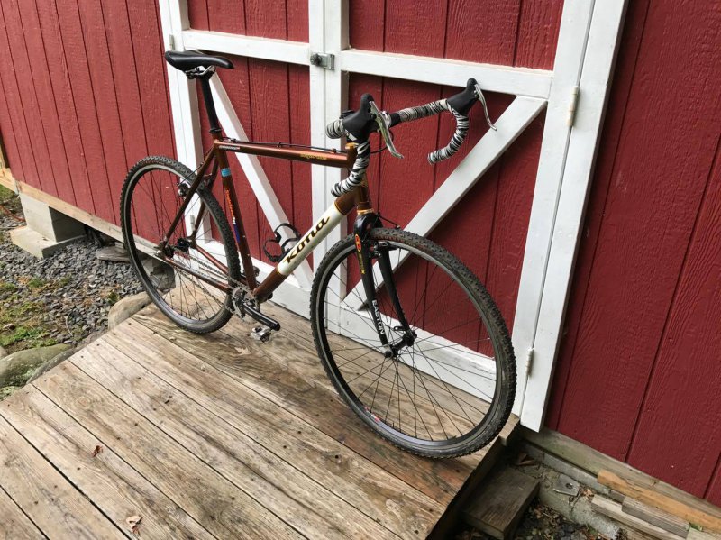

First time wheel build and first time gluing tubulars; PDX's on Major Toms. So much YOLO in one bike. New Kool Stop Cross Pads all around and a new 18T ACS freewheel as well.
Did you have all the specific tools for the wheel build?
Any aspect you feel that could have been hacked?
Wanna try this at some point but the tools are so freakin expensive...
-Upside down (or right-side up, with a work stand) bike/zip ties = truing stand
-known good wheel to compare plucked tone to (with the understanding that spoke length must be close to be accurate). Even tension is more important than high tension.
-make a spoke driver by grinding the webs off two sides of a Phillips screwdriver. A nipple inserter can be made from a 2 or 2.3mm spoke; grind/sand a gentle taper into one end, cut it off about 5cm after that, and test for fit into the slotted end of the nipple. You should be able to pick it up after some slight downward pressure, and spin it on the spoke to receive it.
-a dish stick can be substituted by a level table, and standing the rim off the table with stacks of quarters. The distance between the table surface/locknut should be the same on both sides.
-don't scrimp on your spoke wrench.
-oil the nipple threads/seat when installing nipples. No special tools/supplies required, but they help speed the process... Which you shouldn't be doing on your first build, anyway.
The only thing I wish I had was a spoke tension gauge to make sure that is ok. I was just using my old wheels to gauge it by hand.
I used an old spoke to feed the nipples through so they didn't get lost inside the rim. Dipped the spokes with nipple into some Linseed oil before screwing them on the actual spoke. A small flathead screwdriver made for faster tightening of the nipple slack from the outside, the rest was done with a Park spoke wrench on a borrowed truing stand. I used the truing stand to dish the wheel centered as well since the rear hub is a flip flop so the front and rear are both centered.

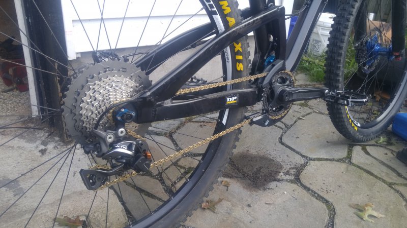

Added E13 lg1 chain guide/bash guard. Upgraded my beat xt derailleur and shifter and went with xtr shifter and derailleur and xt 11-46 cassette. I think I'm going to swap out the 32 tooth chain ring for a 34 since I have the ultra granny gear now.. The 46er seems pointless pedaling on the road but maybe the trails will be different
I've had two chain guards and didn't like either, for me it made the pedaling feel mechanical for some reason. Let me know what you think of it
btw: I like the shima matchy matchy
I've had it for a couple rides now, just posted it today. But yes I agree, mechanical is a good way to describe it. But I'll take it over the chance of dropping a chain. Even though that was rare before.
I used to drop chains all the time, after switching to NW chainrings and clutch rear. You must be doing some insane hits and drops
I ran a narrow wide with a clutch and it never dropped. But shifting with no clutch is smoother so I turned it off and dropped the chain hence the want for a guard
