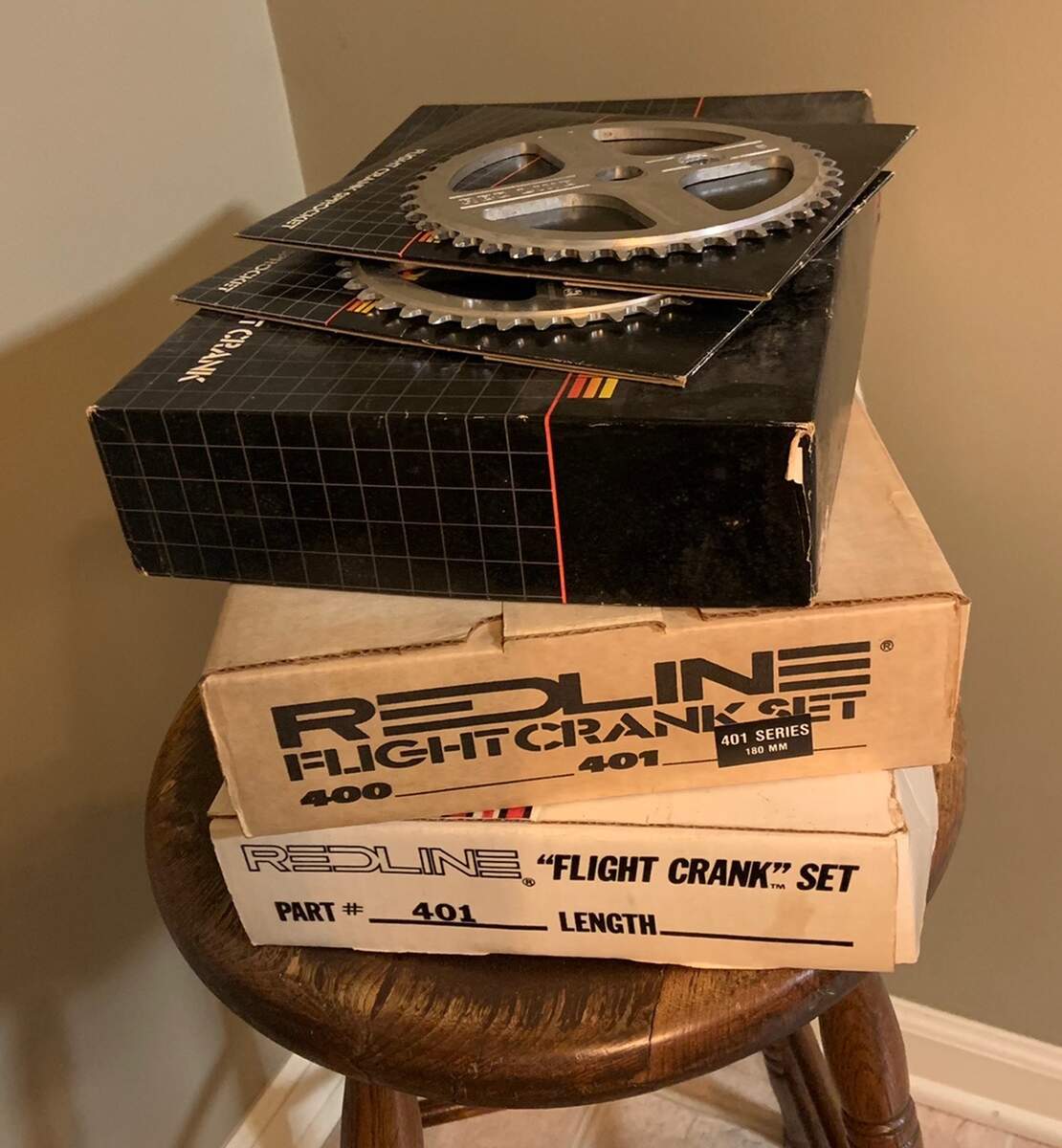

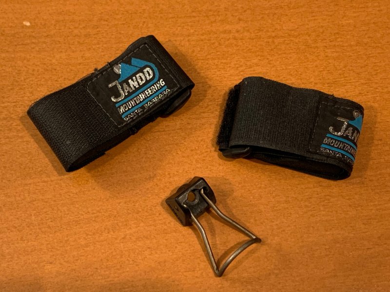

Can you tell I’m sorting through decades worth of bike parts?
