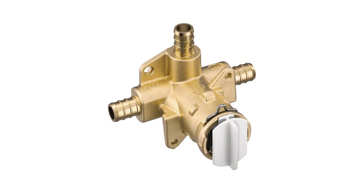

So I've always wondered why the shower valve was off center, now I know why. It needs to move 2 1/2" to the right, which puts the orifice for the cold line in the stud. This has annoyed me for 6 years, so there's no way it's not getting fixed now.
Would it be a bad idea to bore out the stud, sweat in a new nipple, and slide it all over? That would put the joint into the valve inside the stud. I would pex it back to the supply lines. I just don't like the idea of the joint being inside the stud, that would require way too much work if I ever needed to get to it in the future.
Option 2 is to box it out with a header and remove the studs that are in the way. But that's way more work, and I would need to bore through the header to get the supplies through (not sure if that's structurally sound?). This technically isn't a bearing wall, but there is a cut joist that sits right above the stud that's in the way, and the toilet is right there, so I don't just want to cut it and forget it.
Anything else I'm not thinking of?

Thinking this might be the way to go. I don't care about the built-in shut offs, so it should give me a little more room for option 1
the shut-offs are required - although the inspector usually lets it go.
you can't move the stud - it is supporting the joist above it. heading it off creates the same problem with
a header in the way!
bore the 3/4" hole in the stud and move the whole thing over to where it needs to be to center.
then just come back through above the showerhead. copper, pex, whatevs.
don't overthink it.
I have my shower valve on the back wall across from the door, and the showerhead in the end wall.
be creative! it is only copper (or pex) - just pressure test before buttoning it up.
With a gauge? Is there a specific way to do this for the newly installed parts? Or is bleeding the air out, then capping the shower arm and letting it all sit at pressure for a while good enough?

If the pipes can be isolated with shut off valves, that would be the way to go. It also eliminates the need for local shut off at the shower valve.
I have a gauge with a shader valve and 1/2” pipe to screw into the shower head/spicier.
