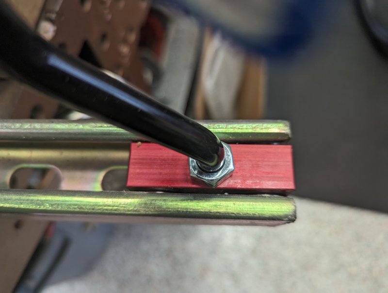

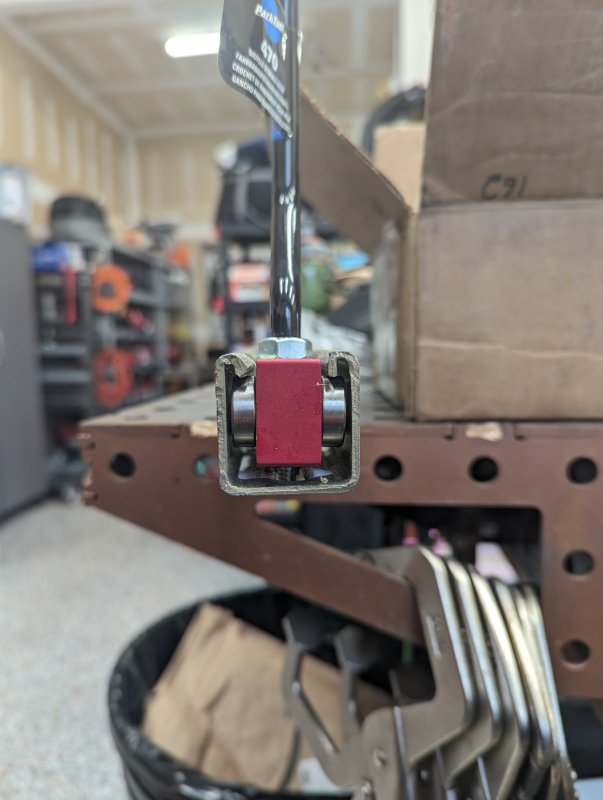

Considering they sandblasted and powder coated the strut the price difference is justifiable, the galvanized rail from HD will eventually rust. I'm going with the HD strut and some trolleys from Amazon plus the Park Tool hooks, not really saving any money but it looks a little sturdier than the 1Up setup and I don't really like the spring action. I'm also thinking to use the same system in a poor man's pocket door setup...

That would make it a lot more expensive, $18 for a M10x1.5 unit...I've reconsidered the whole swivel thing, as long as I can adjust the hook one way or another is fine. Actually, I will just need the hooks to be perpendicular to the rail. I like the bearings of 'my' setup because they bigger. I've also thought of a number of applications beyond the bike rack, I just need to come up with the proper anchoring to the ceiling. Starting with these...
