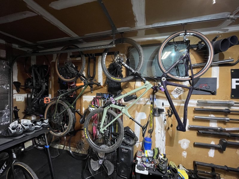

Thought I'd share a little project I just wrapped up. Had bikes on fixed hooks on the ceiling, but wanted to be able to move them around a bit and have them on a slider.
The commercially available systems I came across were either more than I wanted to spend or wouldn't work with my garage set-up. I stumbled across this site: https://shop.gear-blocks.com/product/sliding-bike-storage-rack/ that had a DIY version using uni-strut and hooks they sell that have little wheels on them. Took a little finagling, but the end product works really really well. My garage lighting is horrendous, but hopefully you can see how I pieced this together:
Do the hooks swivel? If so then this may be my Spring project.
Mine do not... The company I bought from sells parallel or perpendicular fixed hooks.
The previous posts in this thread are some ideas for fabbing up swivel hooks for unistrut. Looks like it should be an easy hack using some unistrut trolleys found on Amazon. I may give it shot at some point.

I may be wrong, but looking thru the instructions & all the info on 1up's site, it doesn't look like these hooks swivel (if that's what anyone is looking for). It looks like they're spring loaded and then lock into place in the track...at least from what I can see in the instructions.
For comparison's sake...for my rack I think I'm all in for sub $160 (and the rack is twice as long as 1up's). Actually should be closer to $125'ish...but I opted for 5' sections of unistrut that cost as much as a 10'. Yeah, the hook's don't swivel, but in my situation that's ok...due to space constraints.
While it doesn't say explicitly that the hooks swivel, how could they possibly move up and down without being also free to rotate? Granted, it's not going to be a bearing smooth rotation. If anything, I would replace the spring with a bearing, I don't see the point of the hooks locking in place when they don't have a load...
Based on the instructions, it seems the spring is used to hold the trolley in place when not loaded so it doesn’t move while trying to get a bike on the hook. They do rotate as well.
Yeah, I agree with you...just couldn't find anything actually showing them turning.
That said, just saw this pic which has it spun the opposite direction:
