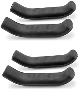

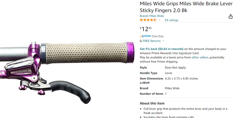

I’ve seen those and off corse I thought I needed them…but, I couldn’t figure out what problem they solved, so I left them alone. I’ve bent or scratched a couple of levers, but never had them pulled forward, is it a thing?

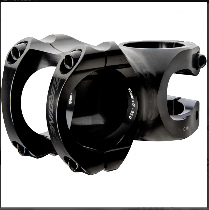

Even with the short stem, it's probably going to be more like RAD+, which is ok. I'm using this bike more as an all day ride and endurance bike.
I don't do any of that silly math, but I do measure my bikes I like (add grips-to-rear-axle and stem-to-rear-axle measurements), then translate this to the new frame when selecting parts. I'm also a BIG fan of Riser-Bars...
