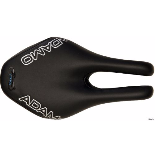

you need perineal relief! (perineum medical term for taint) that will get the saddle into the right position, and remove pressure where it isn't supposed to be.
other issues can arise from pressure there..
if you are leaning on the bars to take weight off your sitbones that is another issue (and it is an OTB problem waiting to happen)
to go way off the charts there, check adamo saddles - think Jason has the loaners ??
