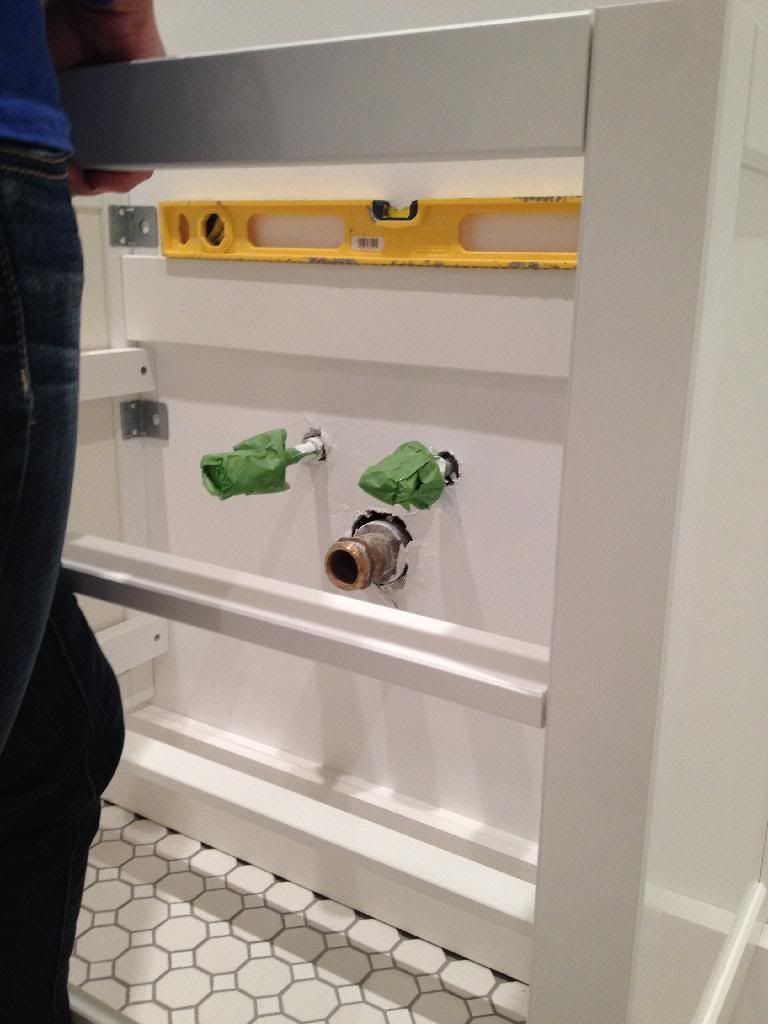

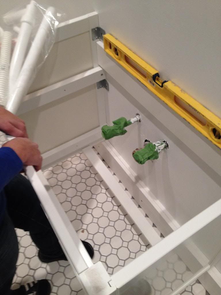

The part that Mandi didn't cover was how the plumbing is suppose to work with these drawers. IKEA sells some trick plumbing, but not sure if we will be able to make this work... Plumbers reply
That mirror is certianly mandi height 😛
Are the doors in the vanity notched in the back for the plumbing? The vanity we have in our powder room is notched for the plumbing to fit. The hardest place to cheat for space is the waste water trap, there just isn't getting around the big u shape at the bottom. Wood need to see the door to comment.
the doors are not notched. the plumbing is suppose to run behind them, super tight. Mandi should chime in with what it looks like.
The fittings for the water have extension in them for sure, so I know i could take them out and shorten them. The drain is the one in question.
i took the tape off before we left sadly.
It irks the crap out of me that they watermark every picture like that. I'm going to write a letter to her in Excel and tell her to cut that shit out.
Turning the water trap to the side should work fine, I guess the main issue is if you existing lines are short enough to not hit the doors. Not gunna know until you put the doors in.. Hopefully there isn't custom notching in your future.
we left as we thought about it, but it looks like the drain is threaded in, can't i just cop a shorter jaun?
hard to tell from the pic, but usually that part of the waste line is hard to mess with without tearing into the wall. I am not well versed there doe.
