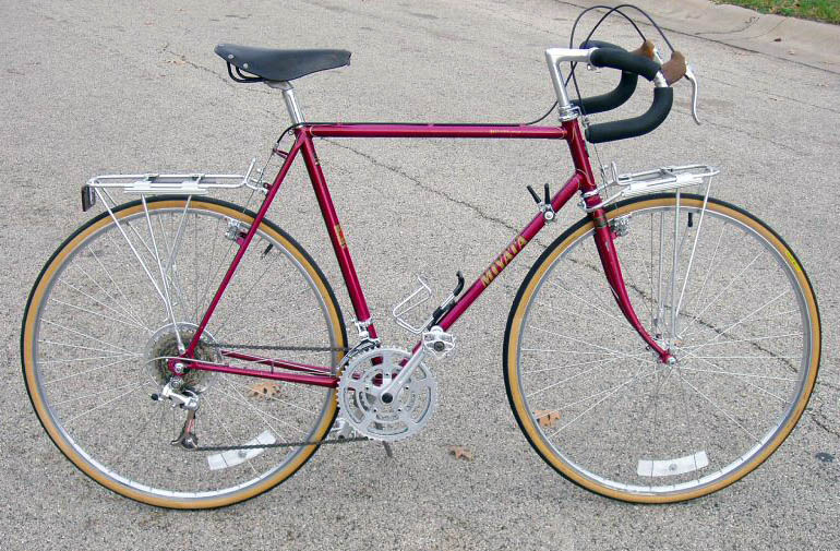

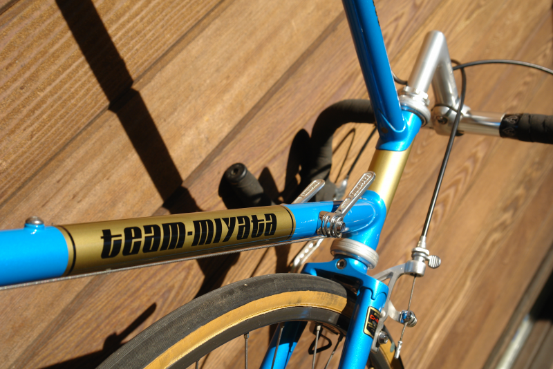

I'll become a roadie and ride a vintage mayata and never care again
I had two Miyatas, my favorite of the stock Japanese vintage variety, I miss them
'81 Miyata 1000
'84 Miyata Team
