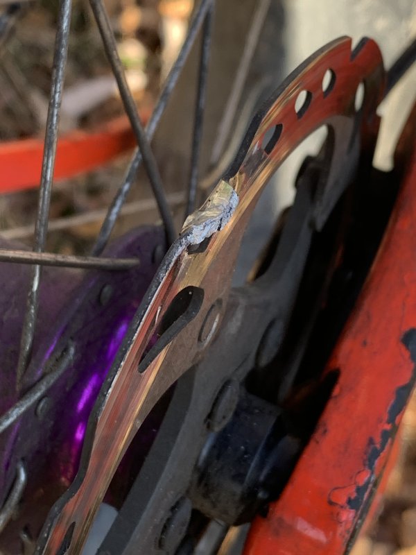

I've replaced rotors due to wear on several occasions. They don't look worn, but if you hold new rotors up to them, they are laughably thinner.
Like, did you actually laugh?
Yeah, because I would have never thought they would wear that much.
Apparently they are also more frail when they wear down.

Somewhere, a bike engineer's head just exploded.
Do you think they put the minimum thickness spec on the rotors for fun?
